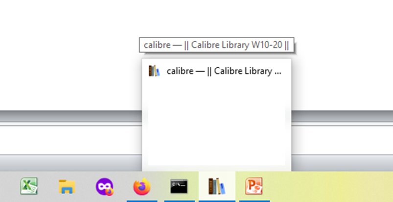

When starting it now, it loads but then seems to get stuck in the task bar without the ability to maximise the window.

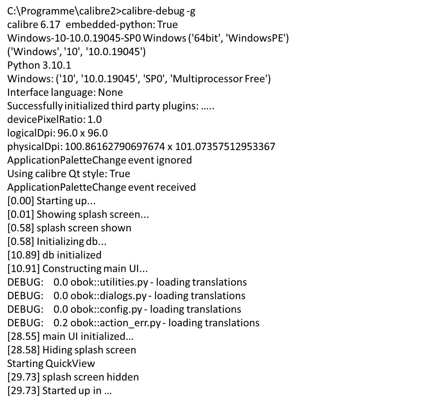

So far I have tried the following:
- removing the current version, cleaning registry, reboot, installing ==> same result
- all antivirus deactivated
- removing the current version, cleaning registry, reboot, installing previous version ==> no change
- same procedure with all antivirus/malwarebytes deactivated ==> no change
- installing current version again
- and I tried with both versions starting calibre without the "regular" db alas with the same result
and now I am at a loss and hope someone has the time to check this.

Or the calibre window is off-screen. Try right-clicking on an empty area of the task bar and choosing "Cascade windows." This is easier if other open apps are closed.
Would the preview be blank if it was just off screen?
Cascade does not provide previews, it produces 'normal' windows resized and repositioned. Which is why it's recommended other active programs be closed before using it; if they're not then their windows will also be resized and repositioned.
To quote the OP:
