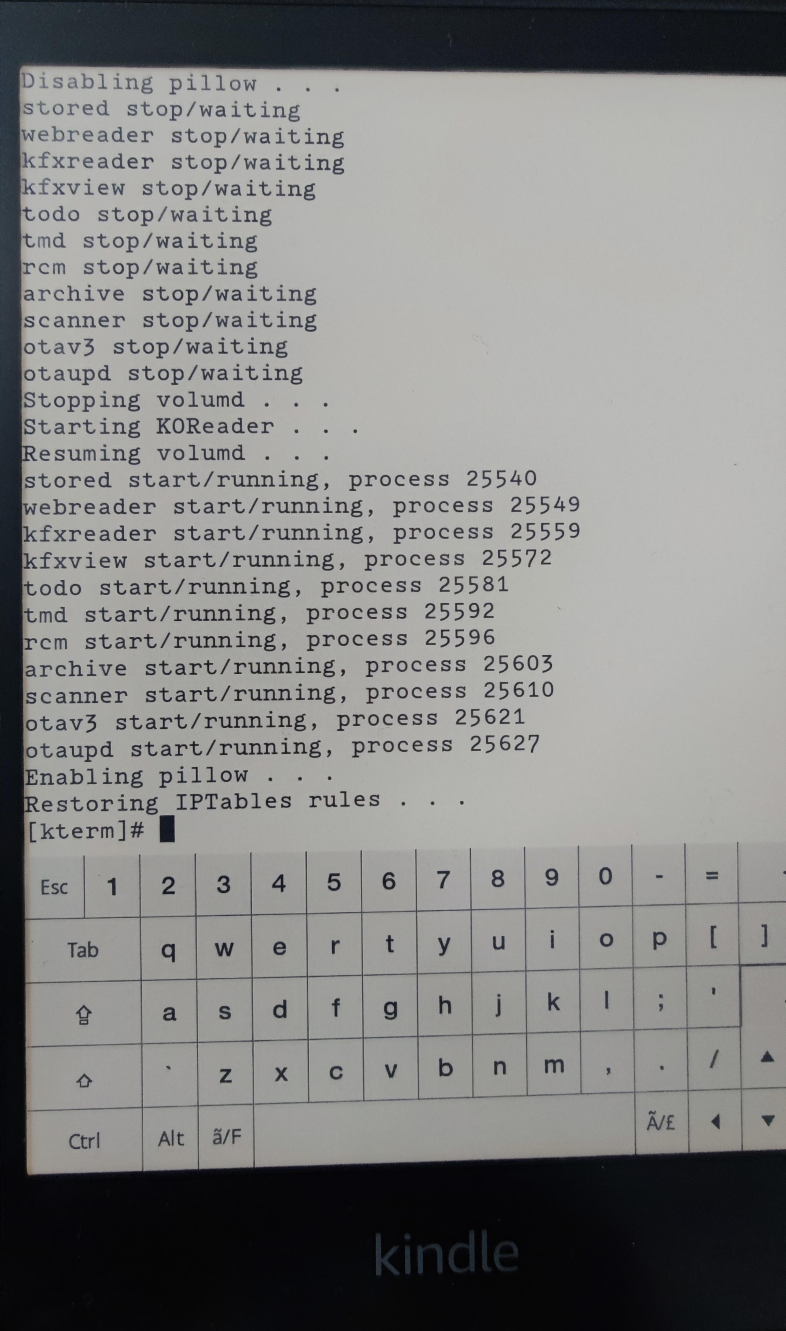

Do you have KTerm? If so, try running `sh /mnt/us/koreader/koreader.sh`.
Also check for a `Crash.log` file in `/mnt/us/koreader/`.

thank you for replay this is the crash.log

Kterm
