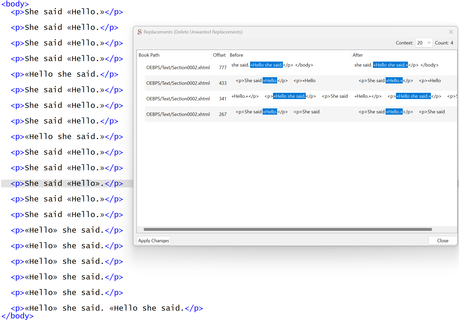

You should be able to limit your FIND to a single line using the options drop-down. Then use a negative lookahead to limit it to lines that do NOT have the »
For example:
Find: «(.*?)(?!»)
Replace: «\1»

In the options of the Find and Replace section at the center bottom of the Sigil window, I cannot find the single line option.
the «(.*?)(?!») code find all phrases that start with « character, with or without »
where i'm wrong?

Sorry, I’m away from my computer, but IIRC, you want to un-check Dot-All.
From the Users guide:
DotAll: This regex option prepends (?s) to all regex searches and is used when you want .* to match any character, even across lines.

Uncheck Regex flag "Dot All" "Dot All" means that a "." will match all characters including a new line character. By unchecking it, you limit wildcard matching to a single line.
FWIW, using that regex and Sigil's replacement table, you should be able to quickly scan all matches for the few problem cases. If not, try a different regex to limit things even further.
Check out the Sigil Users Guide for more info.

This is the Regex I used for many years:
Search: (“[^”\r\n]*)</p>
Instead of using LEFT/RIGHT DOUBLE QUOTES, substitute whatever quotations you need for your language.
In your case, you'll use left/right guillemets:
Search: («[^»\r\n]*)</p>
This will catch lines 1+3:
<p>«This is a test.</p>
<p>And this is more «This is a test.» And more.</p>
<p>Testing. «This is a test.</p>
<p>«This is a test.»</p>
but skip 2+4.

Then get rid of that final </p>:
Find: («[^»\r\n]*)
This will find each of the open quote, all the way to a closing quote OR end of line:
  • <p>«Have you been here a long time Terry?» ... «About five days» he replied.</p>
and it will catch stuff like:
  • <p>«Have you been here a long time Terry?» ... «About five days he replied.</p>
    • 2nd close missing.
  • <p>«Have you been here a long time Terry? ... «About five days» he replied.</p>
    • 1st close missing.
  • <p>«Have you been here a long time Terry? ... «About five days he replied.</p>
    • 1st AND 2nd close missing.
    • (Although you'd only catch 2nd after correcting the 1st one.)

Heh, yes, this will catch some of the punctuation errors.
2 LEFTs in a row:
Find: («[^»\r\n]*)«
  • <p>«Have you been here a long time Terry?« ... «About five days he replied.</p>
    • Wrongly flipped guillemet / OCR error.
So, if you want the pure regex method, you'd create a big ol' collection of "Saved Searches", going from the easy-to-catch stuff—like 2 LEFTs or 2 RIGHTs in a row—all the way down to the hardest-to-catch.

Edit: This is an answer to Jon's question...not trying to repeat what Tex already answered above...
But what if the dialog is something like «Hello» she said.
You would end up with «Hello she said.»
Sorry It took so long to reply. I was off being a kid in Orlando...
To answer your question, Jon, No. In general, the ? in the capture group forces it to be a minimal match so it would stop capturing at the first legal stopping location. Your example has a closing » so it would not trigger a match.
However, there are two points that I would change based on the discussion above (and my chance to test now that I'm home - which I couldn't do on my phone).
  • Instead of using the negative lookahead on the » I would use a positive lookahead on the </p>
  • I would add the » to a 'not' in the capture group
«(.[^»]*?)(?=</p>)
That would capture anything preceded by a « that doesn't have a » followed by a </p>, without capturing the </p>(eg. just the text).
You are correct that the «\1» would place guillemets around the entire captured text, but this process was never intended to be completely automatic. There is no way for the Find/Replace to discern what is dialogue and what is not. If you use the "Replacements (Delete Unwanted Replacements)" table (see attached image) you would quickly be able to see which sections have an opening « with no closing » highlighted - with what it would look like After the replace. As KevinH mentioned above, you could quickly remove any lines that didn't match the change you wanted...apply changes...then run the find again with a different replace criteria.
ie. the above would not find "<p>«Hello she said. «Hello she said.»</p>" until you ran a different Find with the « in place of the look ahead </p> Like: «(.[^»</p>]*?)«
That would probably be the fastest (least # of iterations) way to search through the text to find those types of errors.
