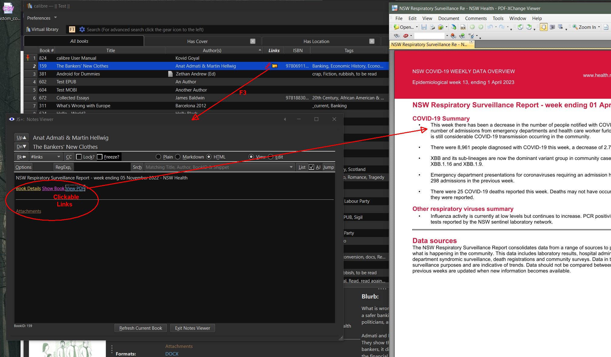

It's at my finger tips, F3, Ctrl+N, Tab to link, Enter
Name:	Screenshot 2023-04-22 083610.jpg

I may have raised this before.
The Browse button in the long text editor Link tool does not allow selection of a folder. If you want the resultant file:\\\ URL to open the folder, you must select a file within the folder, and then cut it out of the Enter URL: field.
I have a sneaking suspicion this maybe a Qt issue.
