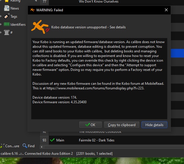

I was indeed running 6.15, as well as the current Kobo software, and got the message I said, despite what Kovid said. But today I saw that there was a new version of Calibre, 6.16, and thought that would solve the problem.
Sadly not. I am unable to do things like delete books from my device from Calibre, anything that involves the database. Please see the attached screenshot.

Follow the advice given in the popup whose image you posted. Go into the configuration for the KoboTouch and/or KoboTouchExtended driver and under the Metadata tab, click on the Attempt to support newer firmware. In my testing, I have not found any issues with doing this with an Elipsa 2E
As to how/why you are getting this error with 4.35.20400 is a rather interesting question unless there has been an regression error in calibre.
Edit: I took a look at four of my Kobo's that are running 4.34.20400 and in their KoboReader.sqlite databases, the DbVersion was shown as 171 while @RonaldP shows his system as reporting 174.

I could bump the version number to 174 in the driver, but I have no way of knowing if there are actual changes in the database that could break things. Ideally someone with this firmware needs to test things thoroughly with the attempt to support newer firmware option enabled.
Since @DNSB says things seem to work, I will go ahead and bump it for the next calibre release.

Actually, this is getting very odd. I updated my Clara HD to 4.36.21095 and the database version was bumped to 174. I then downgraded to 4.35.20400 and, as expected, the database version remained at 174. This leaves me wondering if @RonaldP manually updated to 4.36.21095 and then downgraded to 4.35.20400.
Kovid: please bump the version number in the driver since @PeterT hasn't been around MobileRead for quite a while.
