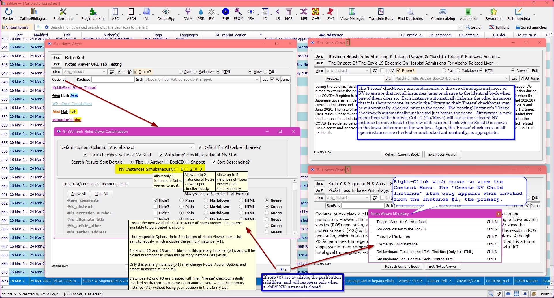

Version 1.0.235 Minimum Calibre Version 6.15
Version 1.0.235 -2023-04-21 Notes Viewer: decode url encoding; multiple instances of Notes Viewer as a new option; Minimum Calibre Version 6.15.
Refer to the attached image that explains the new NV option for multiple instances.

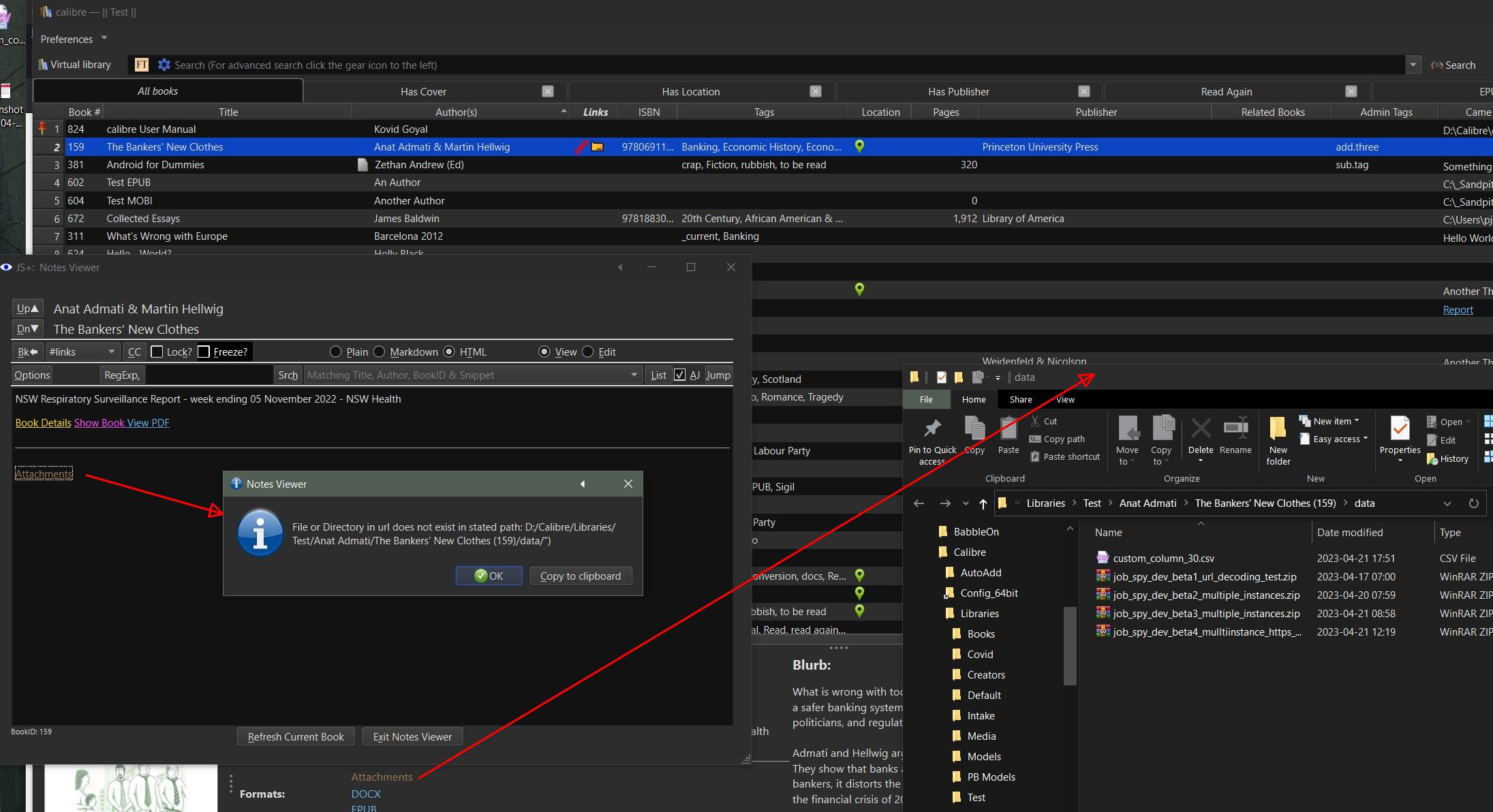

file:\\\ links to a folder aren't working:
calibre, version 6.16.0
Notes Viewer: File or Directory in url does not exist in stated path: D:/Calibre/Libraries/Test/Anat Admati/The Bankers' New Clothes (159)/data/")
This is the HTML code:
<p><a href="file:///D:/Calibre/Libraries/Test/Anat%20Admati/The%20Bankers'%20New%20Clothes%20(159)/data/"><span style="color: #9e7852">Attachments</span></a></p></div>
I'm sure they were working in a prior release.
You never gave me any test data with not only double-quotes, but also a lone single quote: Bankers' . If it had been url encoded as Bankers%27, it would have worked.
I really need you to run that example in calibre-debug -g and post the log. I cannot do it because I don't have any file paths even remotely like that. Using your log, I can determine exactly how to do what needs to be done. I get Python syntax errors even trying to hardcode a test url with that value without doing crazy things, and that isn't 'real-life' testing.
Thanks.
DaltonST

The HTML comes from NV Edit->Create Link->Browse tool.
The link works on the Book Details panel
Name:	Screenshot 2023-04-22 093911.jpg
I'll post the log in a few minutes.

I was just about to release the next version (without these last tweaks) when you posted your error.
Your file url error was caused by Qt creating QUrls differently based on whether there is a grammatical ' or not. If there is, it surrounds the url with double quotes. If there is not, which is what I had previously tested ad nauseam, it surrounds the url with single quotes. NV handled the latter case, but not the former, causing a bad path error in Windows. As I mentioned earlier, it was the Banker's single quote that broke it, because Qt used double quotes instead of single quotes.
Maybe you will find some really good new combinations that will be tested.
