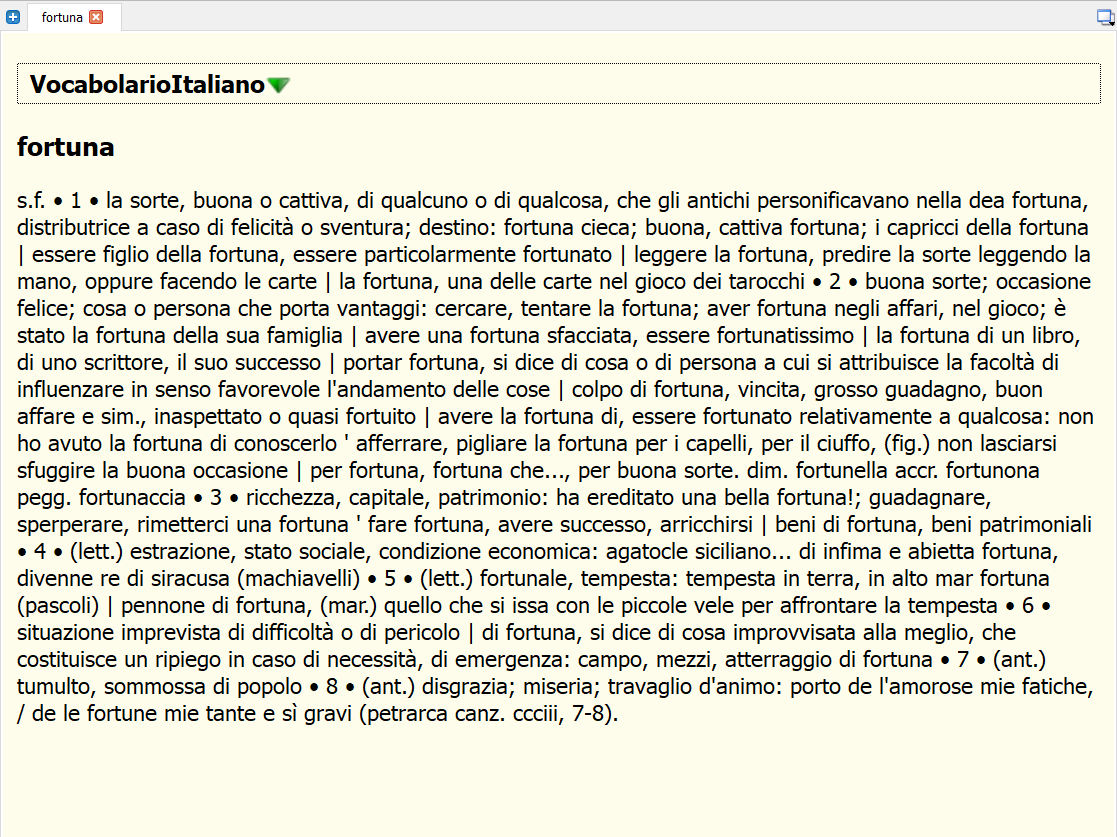

I unpacked the .dic file with this script I wrote: https://gist.github.com/anezih/b20e2...861efeff3f6072
When unpacked, I got a TSV file of 20K entries, which is way lower than the 80K of txt file. Anyway, I was able to convert the TSV file to the StarDict via PyGlossary, see the attached screenshot.
If you want to convert it yourself run: python pocketbook2tsv.py VocabolarioItaliano.dic
EDIT: There was a bug it seems, now it finds 80449 entries.
