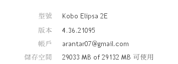

Firmware 4.36.21095 compatible with Calibre?
Originally Posted by arantar05 View Post
Hi, I get kobo elipsa 2e today
It force update to new version
Current Kobo Version is 4.36.21095
Current Calibre version is 6.15.1
It can't connect device now : (
This is taken from a thread in the Calibre forum. But it's better here.
Is Calibre 6.15.1 compatible with firmware 4.36.21095 or will the drivers have to be updated to be compatible?

Old 04-20-2023, 10:44 AM   #4
arantar05
arantar05 began at the beginning.
Join Date: Apr 2023
Device: kobo elipsa 2e
TKS JS ..
I used debug device detection

Have a read here https://www.mobileread.com/forums/sh...d.php?t=118560 and follow the directions. The problem is that the Elipsa 2E is a new device and not yet recognized by Calibre. This will get Calibre recognizing it for the next update.
