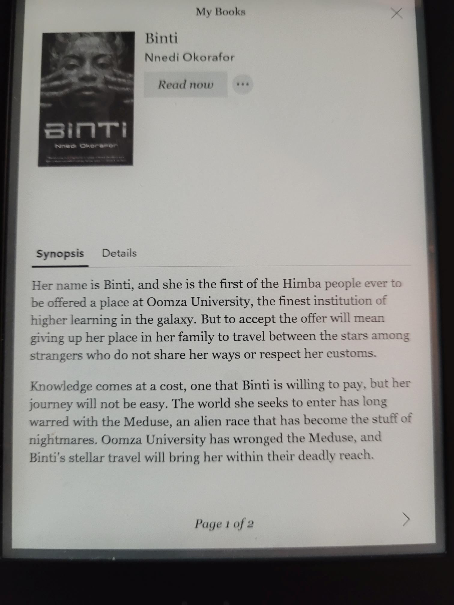

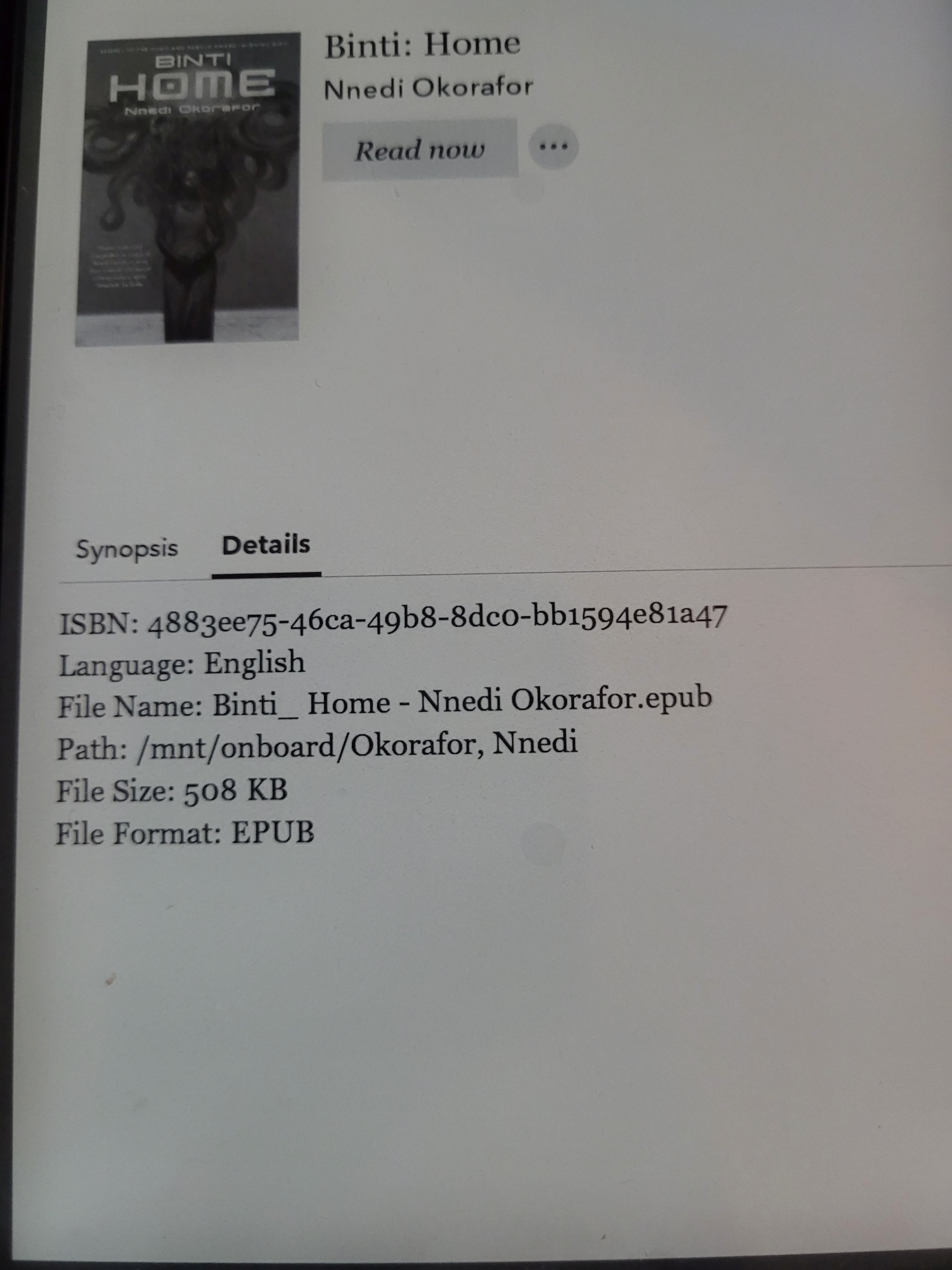

First time using Calibre. I have a Kobo Clara 2E with the latest firmware. I've just put a whole bunch of ebooks on it, with a mix of epub and mobi file formats. With a lot of the books I've copied, I don't get anything when I go to the synopsis / description section.
I've attached a couple of photos to show what I'm referring to.
How do I use Calibre to pull or add the synopsis to the ebooks?

Do you have the synopsis in Calibre, in the comments?

Edit Metadata -> Download Metadata and Covers -> Configure Download -> Tick 'Comments' (and any other metadata you want to download) and download metadata for that book or books.

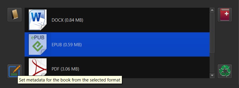

Open Edit Metadata, find the following, its location will vary according to which MDE layout you use, select a format and click the bottom left icon:
Name:	Screenshot 2023-04-19 181922.jpg
Observe the tooltip - almost everything in calibre has one

Post #3 takes you to the basic over all setting
AND for even finer control, you can do by source. This allows you to cherry pick.
Same steps as post #3, but, select the source on the left: then click Configure selected source
Also note: not ever source offers a full set of metadata. If you narrow the available sources, your success rate drops. Calibre merges from what it gets.
Another cause for failed metadata fetches: is the wrong IDs {identifiers} are set.
