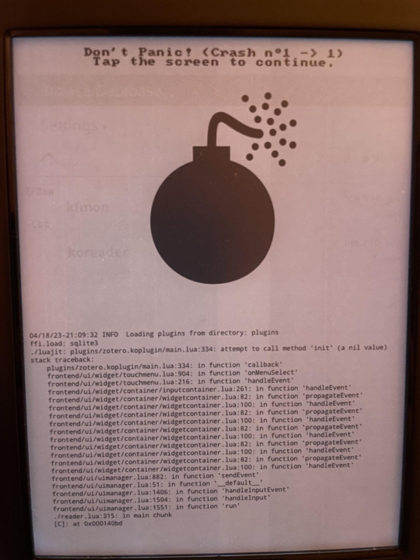

The problem is that on my computer "/mnt/onboard/" is displayed as the root directory (I can't see the "mnt" and the "onboard" folder.
And at the opposite, I can't find the ".add" folder on Koreader because it's a hidden folder.,
I have copied the files to root directory and set the Zotero Path to mnt/onboard/ and is has find the directory !
I have now an other porblem, When I Browse my Zotero collection under Search > Zotero > Browse Database, it doesn't work and it shows an error message (see photo). Can someone help me again. Thanx a lot and have a nice day

I would like to ask you again: does anyone have a solution to propose to me to make my pluggin work? I still have the same error screen (see picture above)
Thank you for your help

Did you try the latest version? https://github.com/stelzch/zotero.ko...15da93d75193d2 sounds suspiciously relevant

Hello Frenzie,
Thank you for your answer and your help.
Of course I tried that before writing. And it didn't work.
It was the right solution though. I only had to not download the three plugin files individually (which I had done) but download them as .zip, remove the "master" extension and drop the whole folder under <KOReader>/plugins/zotero.koplugin
Now it works. Hopefully this can help others.
