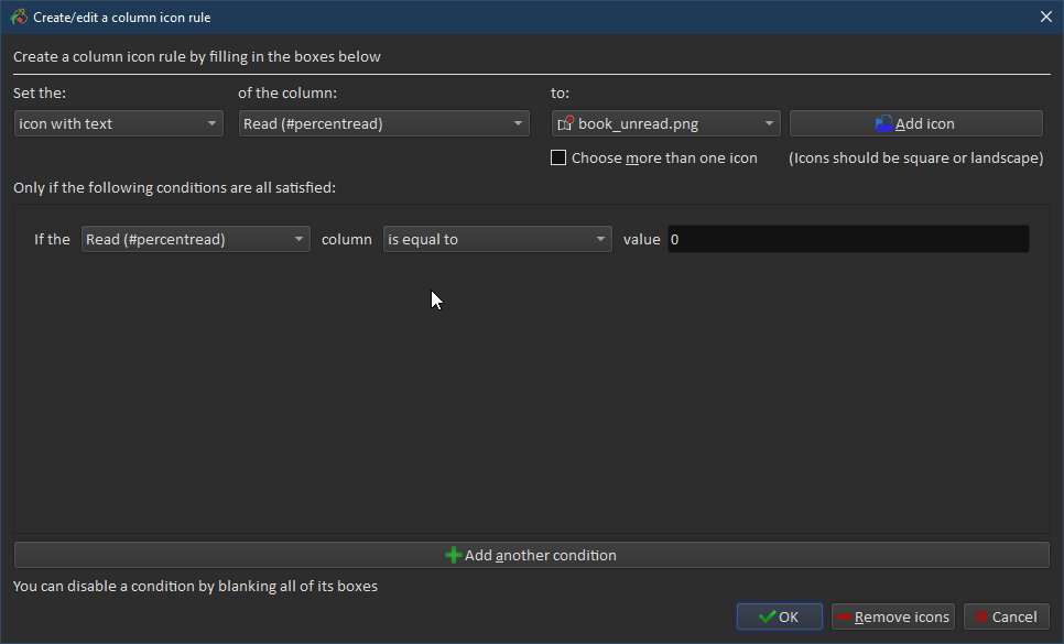

Try these. I'll give you an extra status that comes in very helpful
For read books:
Name:	2023-04-15 22_30_11-Create_edit a column icon rule.png
For unread books:
Name:	2023-04-15 22_30_37-Create_edit a column icon rule.png
For currently-reading books:
Name:	2023-04-15 22_30_59-Create_edit a column icon rule.png
You may want to set "icon without text" instead. The percent-read will still be available via tooltip.

It is asking for an icon?
I don't remember setting an icon for the other 2 I have in there. On the column it just has the number 100 in read. How can I make it the same? (see attach)
