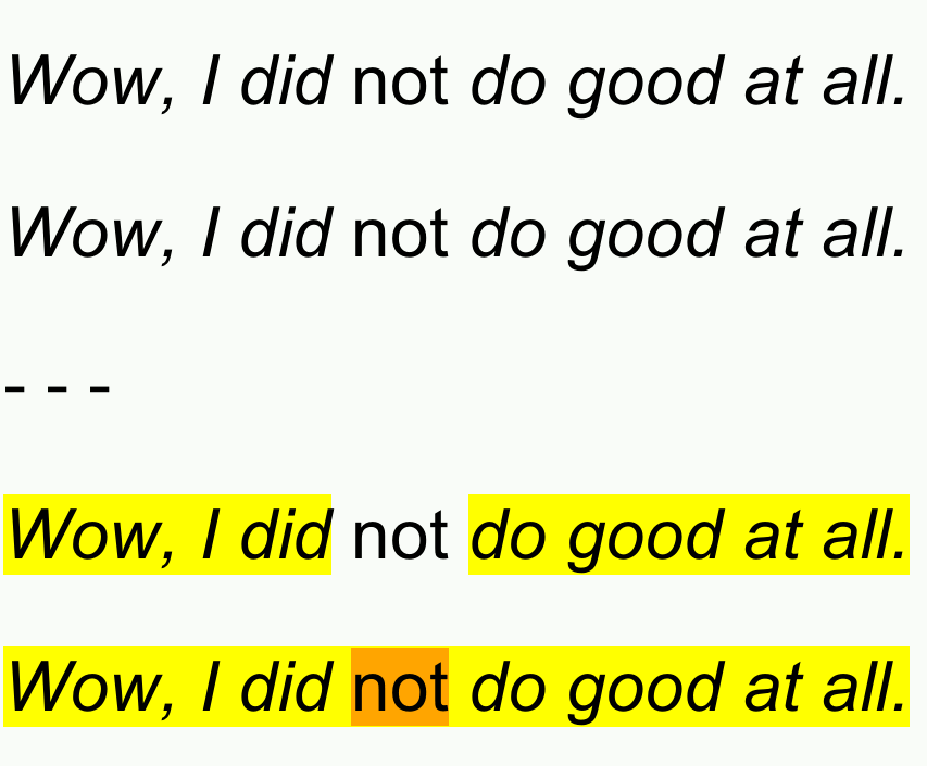

And this is what I meant by highlighting helping you see the differences:
HTML:
<p><i>Wow, I did</i> not <i>do good at all.</i></p>
<p><i>Wow, I did <em>not</em> do good at all.</i></p>
The 1st is how you typical word processor would spit it out.
The 2nd is the type of HTML you would ultimately aim for:
  • <i> = Italics marks the entire "inner thought".
  • <em> = Emphasis marks the emphasized word.
Side Note: And this is the CSS I used to create the above image:
/* These 2 control the emphasis-inside-italics or italics-inside-italics. */
i em {
  font-style: normal;
i i {
  font-style: normal;
/* These 2 temporarily highlight the italics or emphasis while proofing. */
i {
  background-color: yellow;
em {
  background-color: orange;
