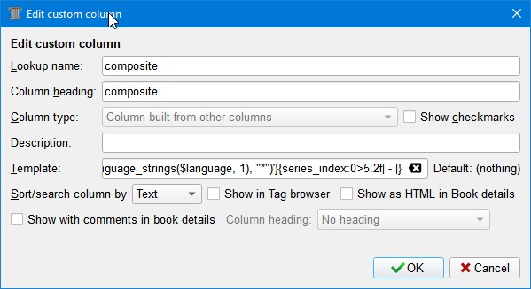

I am the person who gave you the template. However, this thread provides information that is a bit different so here is a different answer. This time I am using Template Program Mode instead of General Program Mode in hopes that is easier for you to maintain.

To use these templates you create a composite column (Column built from other columns, not Behaves like tags). Use whatever you want as the lookup name, the column heading, and the description. Paste one of the two above templates into the template box. Choose "Text" as the Sort/search kind. You may or may not want to check the Show in Tag browser box -- my guess is that you don't because no entry will in more than one book. Don't check Show as HTML. This screen capture shows what I mean.
