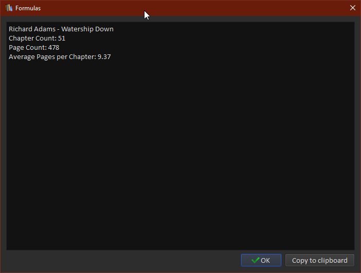

For a formula for various book statistics: is there a function similar to round, but rounding to a certain number of decimal points instead of a whole number?
EDIT: format_number works. New question: How do I add a line break? This returns as one long line.
program:
strcat(
	'Chapter Count:', $#chaptercount,
	'Page Count:', $#pagecount,
	'Average Pages per Chapter:', format_number((divide($#pagecount, $#chaptercount)), '{0:5.2f}')
Old 04-11-2023, 11:35 AM   #569
chaley
Posts: 12,529
Karma: 8075744
Location: Notts, England
program:
strcat(
Use the character() function, specifically character('newline')
Old 04-11-2023, 11:58 AM   #570
ownedbycats
Custom User Title
ownedbycats's Avatar
Posts: 11,389
Karma: 79699999
Join Date: Oct 2018
That works, thanks
