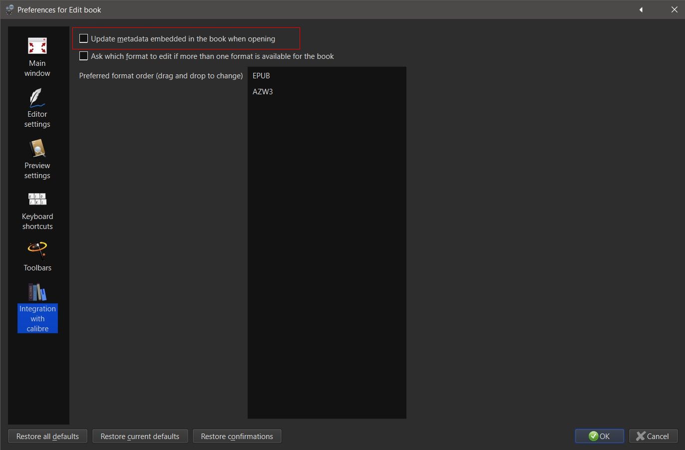

Long shot : Editor: Edit->Preferences:
Name:	Screenshot 2023-04-03 091200.jpg
Uncheck it if checked:
BetterRed is offline
Attachment 200766
It was checked, I unchecked it, it made no difference at all.
