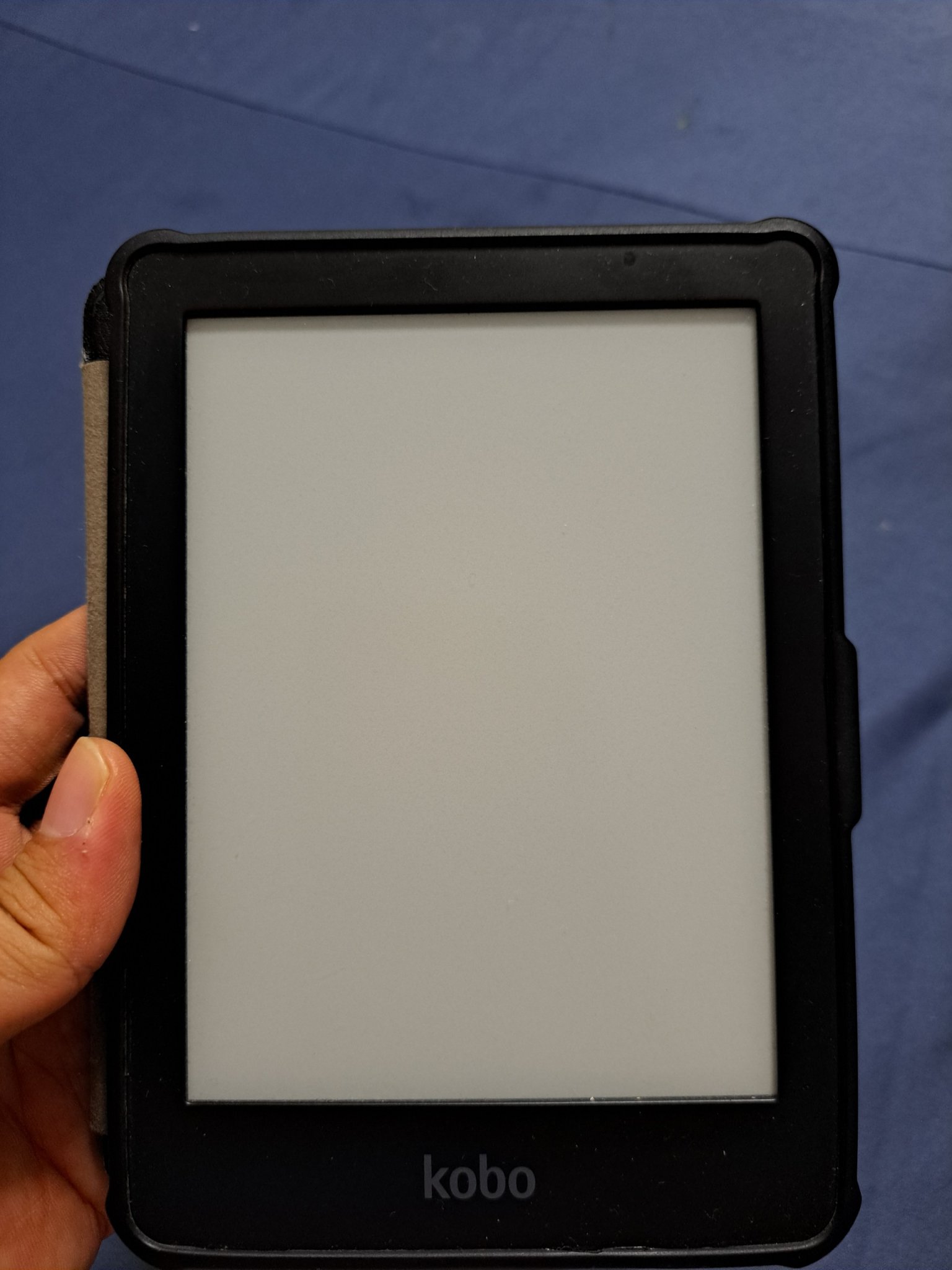

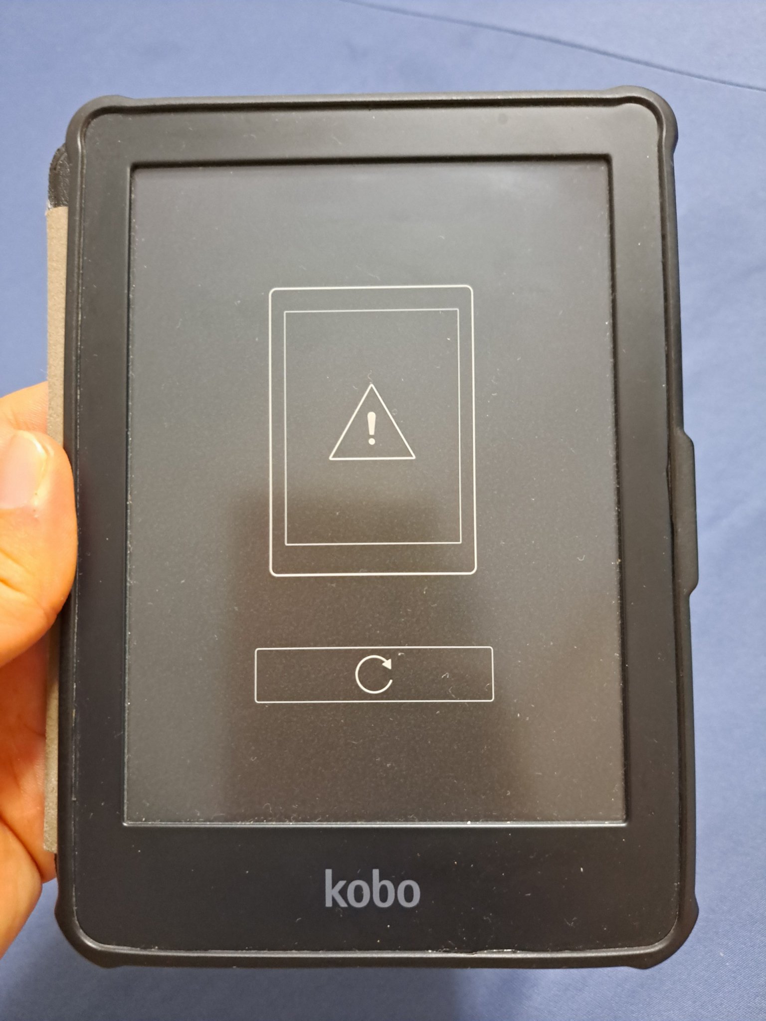

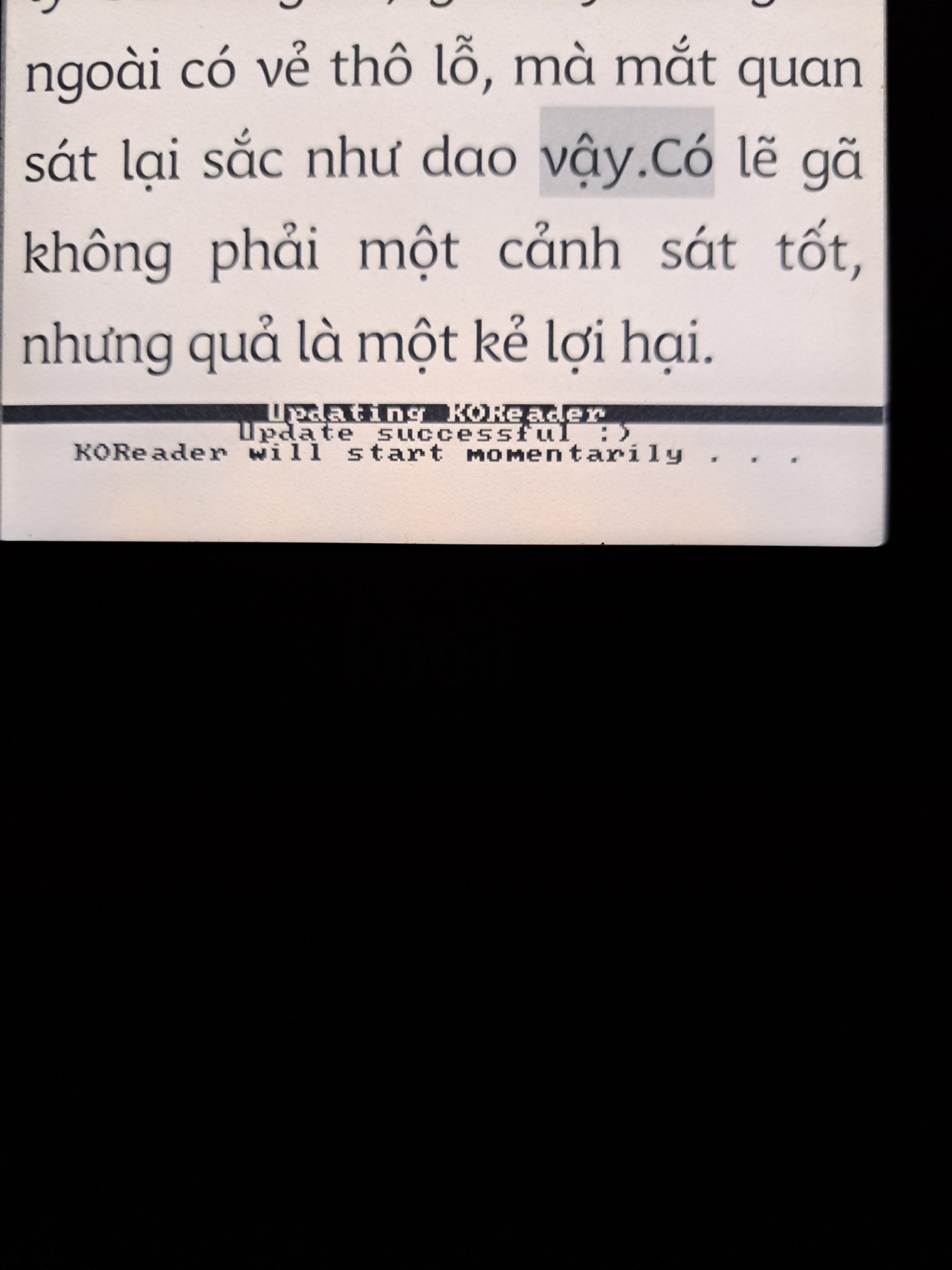

Kobo Clara was suspend after updated
Hi, I have a trouble with my Kobo Clara.
After updated my Clara through "Update option" in Menu of Koreader (Koreader version 2022 maybe, don't remember Nickel fw), my Clara doesn't work any more and shows the death screen below.
What could i do now, please show me the way. Thank you for your help.
ID:	200656   Click image for larger version
ID:	200657   Click image for larger version
nhatkhoa102 is offline   Reply With Quote
Old 03-28-2023, 11:33 AM   #3474
NiLuJe
BLAM!
NiLuJe's Avatar
Posts: 13,507
Karma: 26047286
Location: Paris, France
That looks like the stock recovery screen, and we have absolutely no way to trip that ourselves.
I'm guessing you forced a shutdown *during* the KOReader restart? (Which in itself is perfectly harmless, mind you).
In any case, if the recovery process doesn't actually do anything, it's probably dead storage. IIRC, the Clara has an internal SD card, so you *could* swap it yourself (get a new card and ask for an image in the proper thread in the Kobo dev forum). But, if you can, just RMA it.
Old 03-28-2023, 11:03 PM   #3475
nhatkhoa102
nhatkhoa102 began at the beginning.
Posts: 10
Join Date: Feb 2021
Device: Kobo Clara HD
Thanks for respond.
That's right, I pressed the Power button while it was on the Update Successful screen, but it's because the screen didn't change for a long time (i waited for it about 20 minutes but nothing happened- meanwhile my Libra's updated at the same time and done long before). Maybe my Clara gets slow.
Ok, so maybe my card got damaged? No hope with ebooks inside it?
