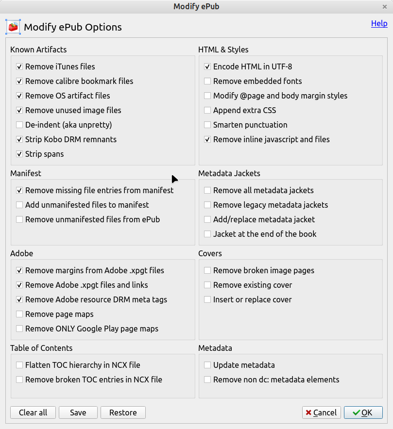

I'm moving this from that discussion in the Editor forum since this is the better location for it:
@gbm and @JSWolf,
I don't use Modify Epub anymore but I took a quick look at the plugin code. I think the problem may be that the plugin is currently only looking for GBS anchors in their self-closing form
<a id="GBS..."/>
i.e. not
<a id="GBS..."></a>
ETA: If Beautify has been run all anchors will look like the latter.
I can't get Modify Epub to remove those Google Play page maps no matter what I do. I've pulled up one of my epub3 books with:
<a id="GBS.0007.01"/>
(self-closing) sitting right at the top of a file (immediately after the <body> statement). I've run Modify Epub against it with every variation of checking the Remove Page Maps and Remove ONLY Google Play Page Maps. The <a></a> pair doesn't go away.
I've also tried it after Beautifying the file (so the codes aren't self-closing):
<a id="GBS.0007.01"></a>
with the same result (codes not removed, though they do get converted to the self-closing variety).
Modify Epub's log always says just:
Looking for pagemaps
Looking for Google Play pagemaps
It never actually does anything with them.

Here is what I have found works after doing Beautify All Files in the editor:
For my first run of Modify epub I use these setting:
Name:	Screenshot from 2023-03-10 17-13-43.png

For my second run of Modify epub I use these setting:

If the first thing I do to an epub from google is run Modtify epub uning the second set of setting then all page marks are removed.

I've attached my Modify Epub settings. Yes, they're different from yours. But, I can't see anything that would stop it from removing those Google Play page maps (again, I've tried all combinations of those two checkboxes). I've also included the top of one of the pages with the play map on it and the Modify Epub log for the run.
EDIT 1: I was also wondering if it might be an epub3 thing. But, since your files are xhtml, I'm assuming that book that you used is also an epub3 (just like the one I'm using).
EDIT 2: And, I've just made another two runs with your first and second set of settings. No difference.
Attachment 200239
Don't select to remove unused images as there is a bug. If the image is specified to be used in CSS (section break graphic), Modify ePub will treat it as unused and deleted it. Use the Calibre error checker and it will correctly tell you if any graphics are unused for you to delete.

If the Google eBook has <a id="GBS...."></a> then Modify eBook won't work to remove them because it's a bug in the code. It has to be <a id="GBS...."/> in order to work.

Modify ePub changed all those <a></a> pairs to self-closing anchors. The next run of ME still didn't delete the (now) self-closing anchors.
enuddleyarbl is online now   Reply With Quote
Old 03-11-2023, 01:41 PM   #1734
Posts: 84,281
Karma: 153715495
What you do is not delete any page maps on the first run and then delete the page maps on the second run.
I've tried it and yes, it does work.

I'm taking a guess that when it looks for page map stuff to delete, it first looks for the Google Play pagemap file (Ops/_page_map_.xml) and the Manifest items (_page_map_.xml (_page_map_)) and either pulls the GBS anchors out based on those or looks for the self-closing tags itself. But, once it removes the pagemap file and manifest items, later runs (when the non-self-closing anchors have been self-closinized) will say "no such pagemap/manifest objects exist, therefore no GBS anchors exist. And it quits. Total WAG on my part. But, it seems to explain the behavior.
So, as you say, the work-around is to not use the "remove page map" options until after doing a run and getting those tags self-closed.

That's what happens from my testing.
