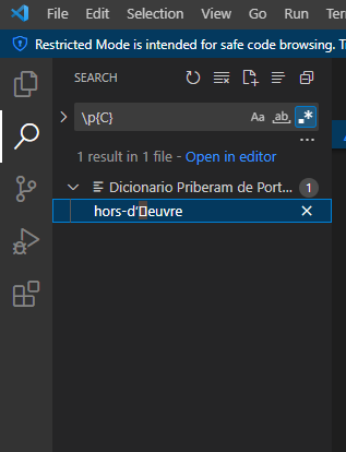

Originally Posted by nezih View Post
You can use \p{C} in Find) Replace those with the intended characters.
Sorry, do I have to put \p{C} here?
Use \p{C} to glance at different control characters. Then, replace those on a case by case basis. Sorry if I can't be of help but without access to dictionary my assistance will be limited.
I sent a dm with the link (dropbox) of the dictionary
I think there might be a problem with KindleUnpack because when unpacked via mobitool, the whole process completed without problem. I'm attaching the Windows mobitool binaries if you want to try it yourself.(Use at your own risk!)
mobitool -s filename.mobi
