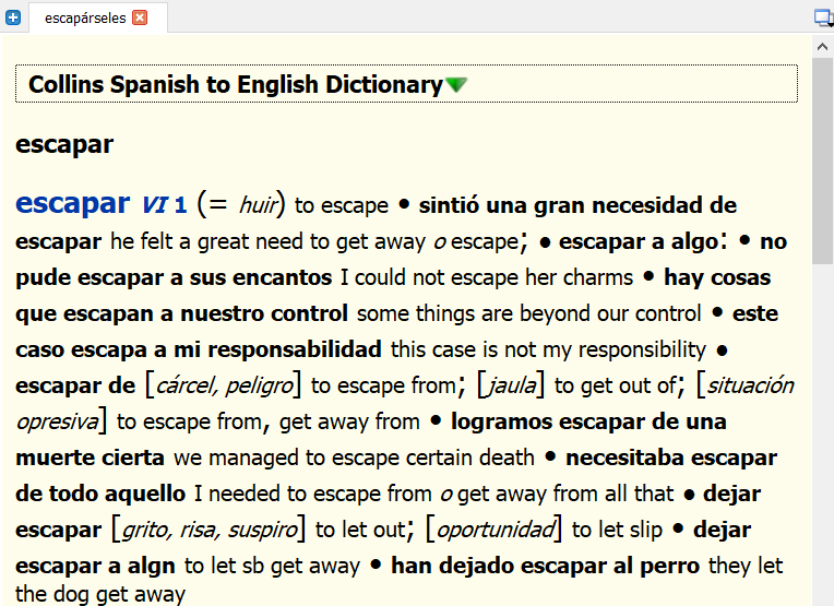

To clarify, the Spanish.zip I uploaded is neither a Kobo nor a StarDict dictionary. It is a json file only showing prefixes, suffixes and cross products of words. The ones I uploaded below at r3turn3r's request are Kobo dictionaries which I added inflections by the help of aforementioned json.
Other than that, escapárseles is not in the json file, therefore not in the resulting dicthtml-es-en.zip Only dictionary in my collection that could find escapárseles as an inflected form of escapar was Collins Spanish-English. If you have the Kindle version of Collins you can convert it to the format you need.

Thank you once more Nezih for this contribution. I put this dictionary on my Kobo and unfortunately, it could not analyse ESCAPÁRSELES, simply giving it as a word not in the dictionary. Whereas, of course, ESCAPAR is in the dictionary.
I will try the modified Stardict dictionary that you gave below and test it also.
Well, the modified Stardict dictionary doesn't seem to be able to recognise ESCAPÁRSELES either. I also had some problems installing it — it appeared with a name that was different to what I had called it. Nevertheless it seems to work but not recognize ESCAPÁRSELES as a form derived from ESCAPAR — sad to say!
Please check the post above with screenshot, I tried to explain the problem.

Thank you once again, Nezih.
The Stardict es-en dictionary appears with the name "Sesotho" on my list of dictionaries on the screen of the Kobo instead of the name Stardict that I gave it and which it has when I open the list of dictionaries contained in the custom dictionary file of the Kobo on my computer. Sesotho/Stardict does recognise many forms of ESCAPAR but not the complex one of my text:ESCAPÁRSELES.
The Collins dictionary does seem to be fantastic for recognising complex verb forms in Spanish, but I don't have the Kindle version and I would be totally incapable of converting it: my technical ability is, unfortunately, very limited.
