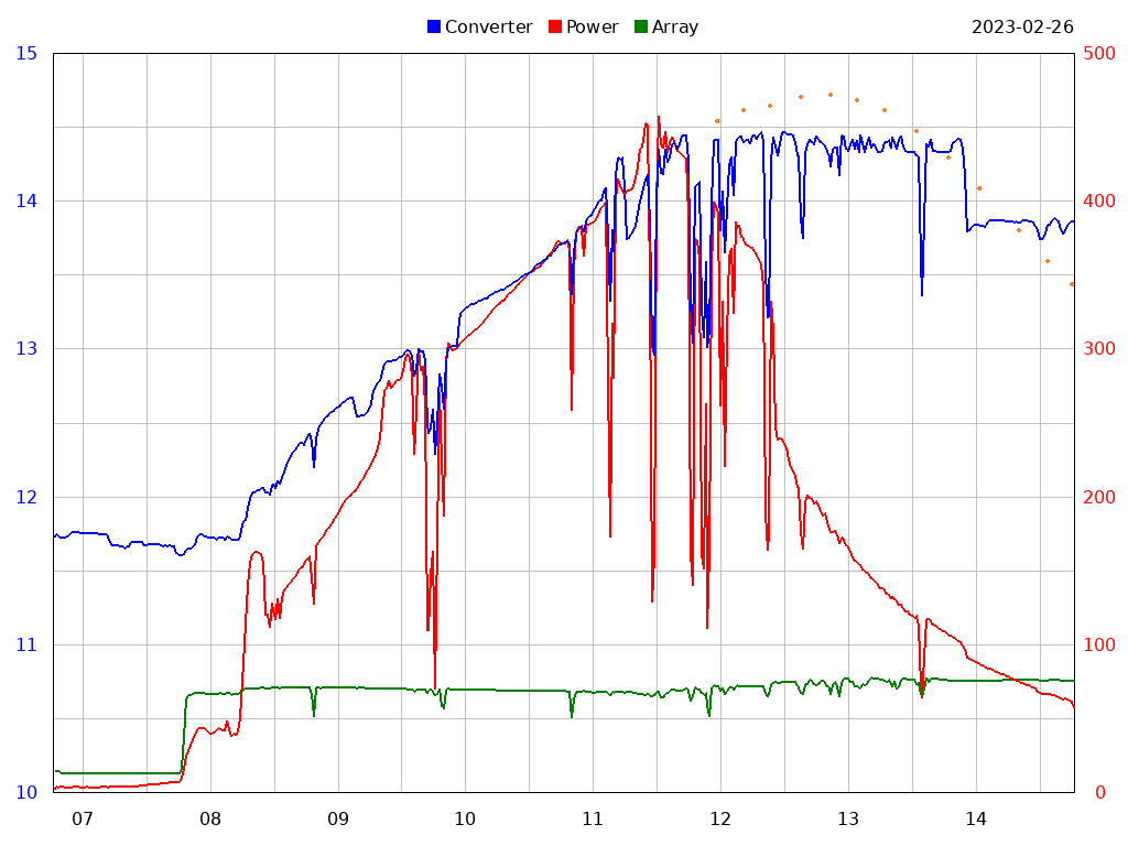

Renate
Onyx-maniac
Posts: 4,125
Karma: 18764971
Lithium only makes sense for portable gear and vehicles.
One of the real benefits of LiFePO4 is that they will accept whatever charge you throw at them. Lead-acid are happy to take a lot of current initially but will gradually slow down in accepting a charge. If you have a gray morning but then a sunny afternoon, the LiFePO4 will fully exploit the capacity of the solar system and fully charge while the lead-acid will slow down and end up not fully charged.
I'm using lead-acid now that are about five years old. I will replace them eventually with LiFePO4, but there is enough capacity so that I can put it off. The little orange dots (peaking at 12:45, local noon) show you the solar capacity. That the red line drops off sharply after 11:30 shows you that the lead-acid batteries are losing their appetite. They still want to soak up more electrons for another 6-8 hours, but if it clouds up, they lose. Yeah, we had some intermittent clouds yesterday.
Sorry, propaganda from sellers of Lithium batteries.
1) Depends on charging circuit re how Lead Acid charge. Also if nearly fully charged it doesn't matter.
2) "LiFePO4 is that they will accept whatever charge you throw at them." Totally untrue. Once they are charged there is zero charging. Lithium battery life is longer if not absolutely fully charged.
The Lithium tech batteries are less recyclable, use more resources to make and fire / explosion risk is very high if charging HW or SW fail. Lead Acid much safer.
If your batteries frequently get fully charged when loads of daylight left then:
1) If you don't run out of power in dark, you have more batteries and panels than you need.
2) If you do run out of power in the dark, then you need more batteries.
