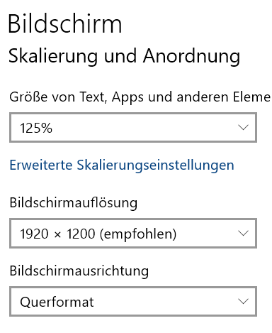

Hello,
I can confirm the issue, not only in text, but also in viewer menu (see screenshots). If I increase the viewer window manually, the text looks ok.
In an earlier update (don't know which), I had the same issue and that was vanished with the next update.
I use Win10 with 125% resolution and 1920x1200 pixels.
ID:	199614   Click image for larger version

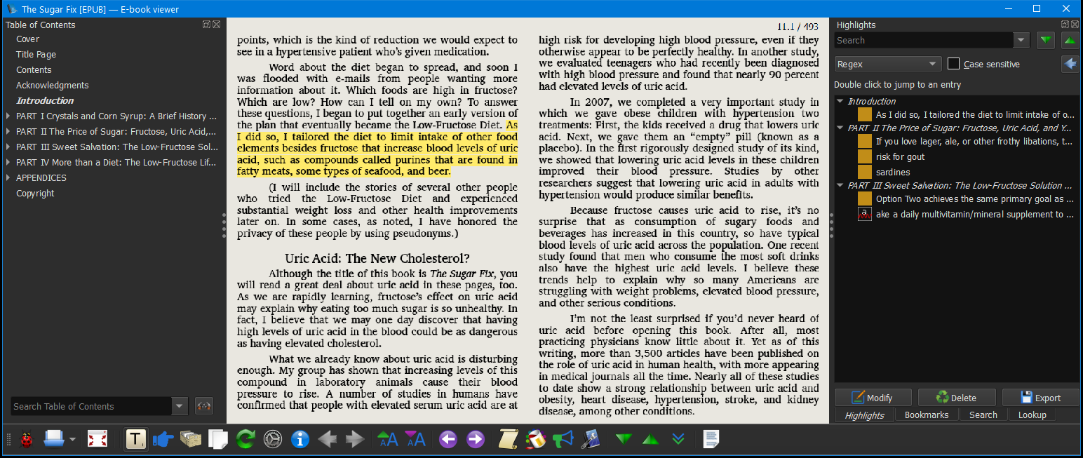

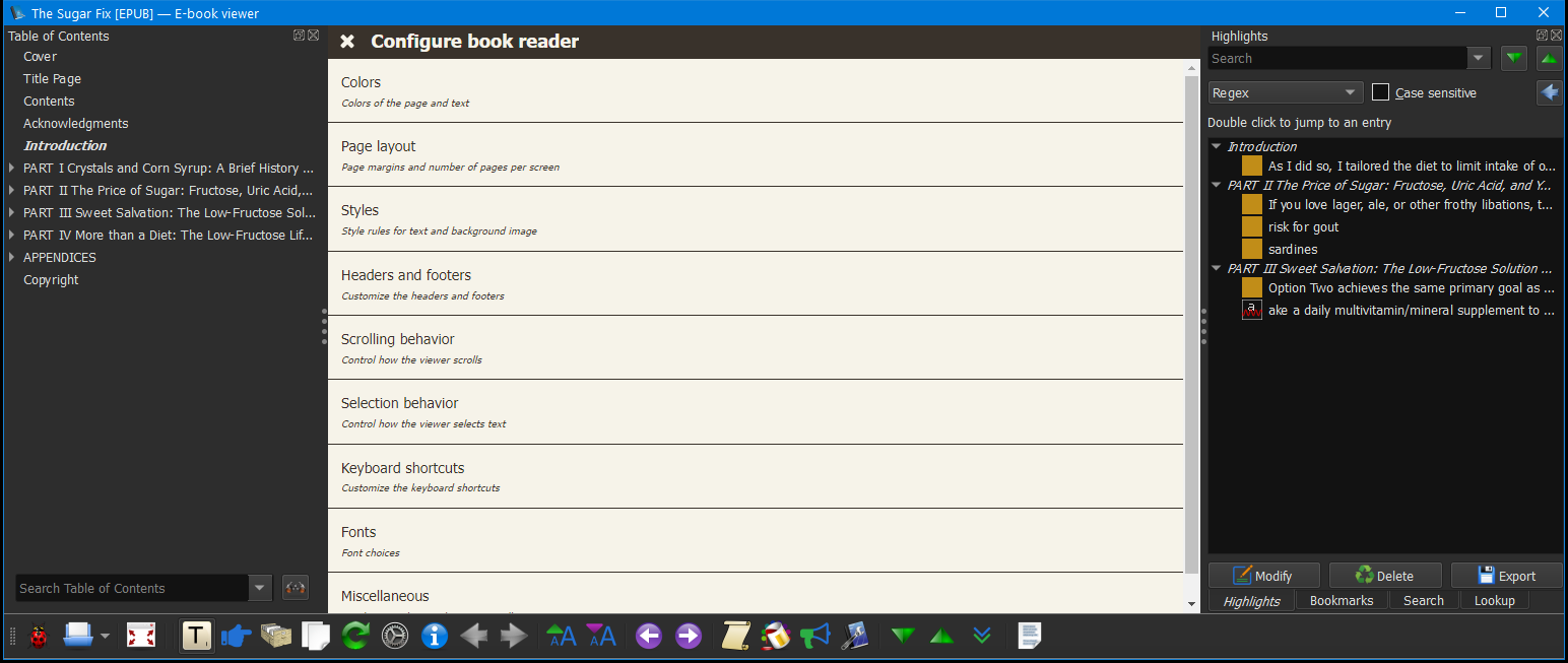

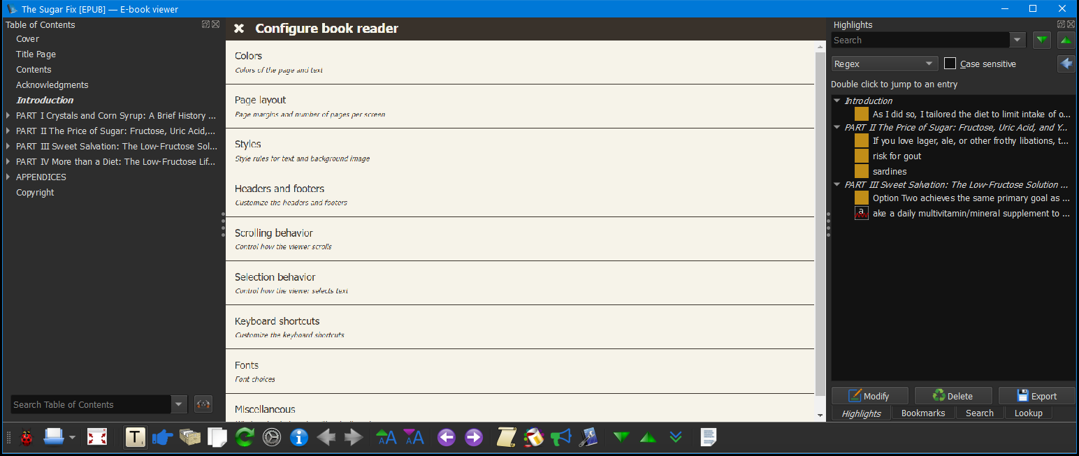

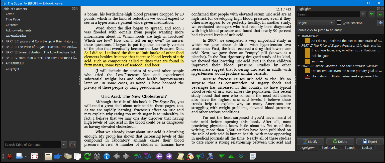

I hadn't noticed when I first saw this thread, but now I see I get the same.
Found it interesting that, after shaking the viewer window, to minimize other programs (the so-called Aero Shake), Viewer UI general blurring goes away.
Before Aero Shake:
Name:	MWSnap0079 2023-02-10, 15_19_48.png
Name:	MWSnap0080 2023-02-10, 15_20_12.png
After:
Name:	MWSnap0081 2023-02-10, 15_20_22.png
Name:	MWSnap0082 2023-02-10, 15_20_34.png

You dont need to use aero shake, just resize the viewers text area slightly once. Basically, as far as I can tell this is an issue caused by Qt WebEngine sometimes failing to resize the OpenGL surface it renders to, which means what it renders is rescaled on the GPU causing blurry fonts.
