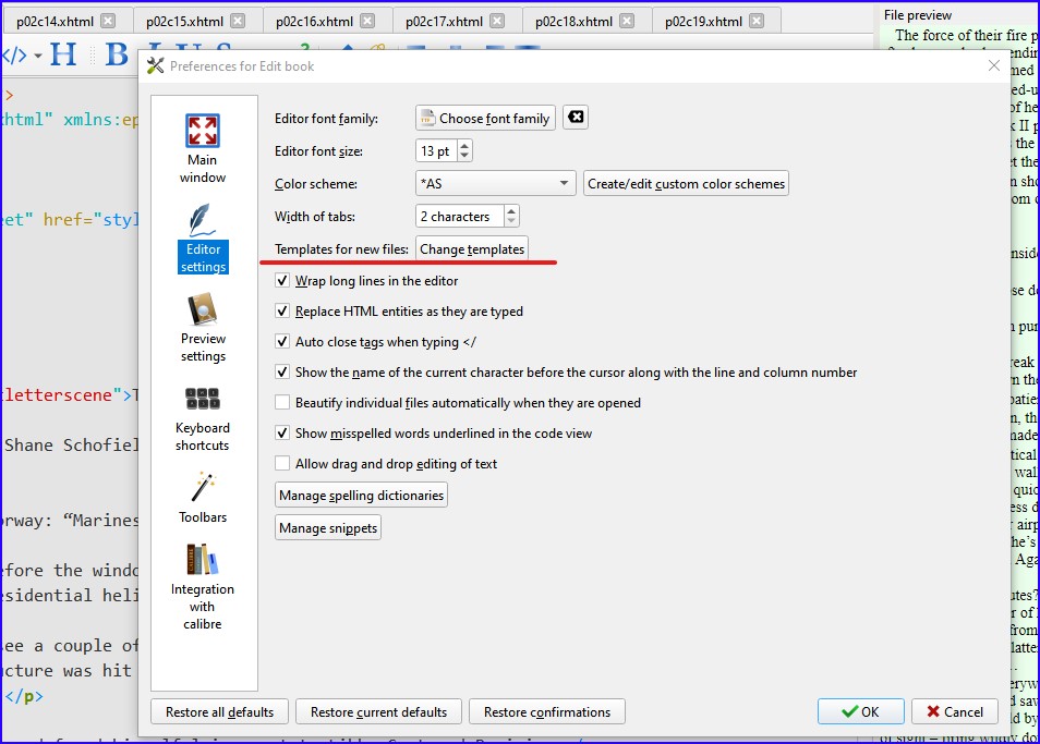

Is it allowable to add a lang= bit to the HTML line of the jacket in the Editor? Unless it's just a function of something I've done, that line in the current book I'm editing is:
<html xmlns="http://www.w3.org/1999/xhtml">
I'd like to add the language stuff so it looks something like:
<html xmlns="http://www.w3.org/1999/xhtml" lang="en-us" xml:lang="en-us">
And, while I'm asking, what about the xmlns:epub= bit? IOW:
<html xmlns="http://www.w3.org/1999/xhtml" xmlns:epub="http://www.idpf.org/2007/ops" lang="en-us" xml:lang="en-us">
Can I, should I, manually change that? Is there a setting in Calibre to do that in the conversion/polish process?
In case you are not aware, you can edit the page template to add the extras you need.
Of course, only works on new pages, not existing pages
I'll take a look at that, too. Thanks.
