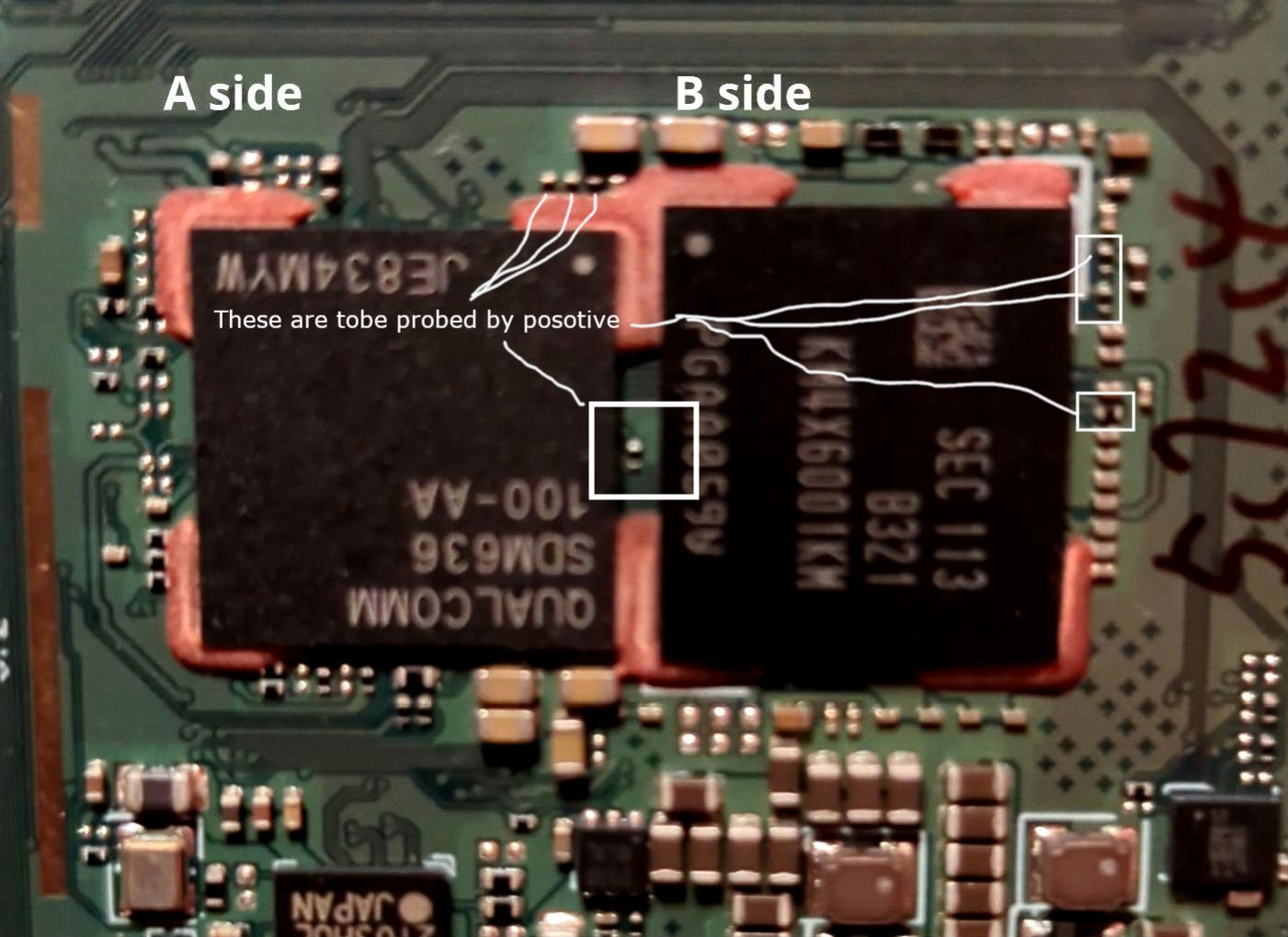

Frank, I've done my damndest to destroy your spirit and you're still ticking!
Ok, now we embark for the darkest shores.
The concept is that if you can prevent your SoC from accessing the flash memory it will say, "I give up. There's nothing here, I'm in a wasteland, I'm going to 9008."
You are interested in the teeny-tiny black rectangles.
The brown/blondish are of no importance.
In this diagram there aren't a lot of useful possibilities.
Try not to short them, connect to one side or the other.
Use the voltmeter in diode test with the black lead connected to tin.
Do a long power button reset and look for 9008.
Prepare accordingly by downloading edl.exe, Zadig and the Firehose loader on that page.
It may be difficult to hit 9008 and you want to be prepared.

My sprints are always good! Its dead to me in current state and can not get any deader (lets make it a word yes)
So I think before i attempt Ill need some study time. duckduckgo to the rescue with luck.
Not sure what this is referring to.
Black probe to tin and red to either side of (assumption here) the diode?...
  1. edl.exe I think I have it setup followed a few different how 2's but not yet tested that it works.
  2. Zadig 2.7 running and have used it.
  3. Firehose loader not sure on this doing reading to gather an understanding of its uses.
When I am ready to begin am I to understand that the success of reaching a 9008 state is on a timer? I have seen such thing on other Chinese devices.
If so what will be the procedure to follow at a successful 9008 (edl state yes??)
Picture attached is for my understanding and for my all important mind map. Yup its a thing
As always i thank you for your shared knowledge!

Little rectangles with a shiny solder blob on two ends are surface mount components.
They are either resistors (black body) or capacitors (tan, brown, blond bodies).
Capacitors are always between different power supplies and for our purposes are boring.
Resistors are often used as "build out", "pull up" or "pull down" and are usually very important.
So, yeah, the positive (red) lead to the resistor, the negative (black) lead to a good ground.
Technically speaking using the meter (in diode test) as a source of confusion is not as impressive as a lower value resistor.

If you just hold down the key it will inject and buffer a zillion keys.
If you hit the keys manually you must make sure that the buffer always has something in it and that there is no 1/10 of a second gap.
The answer?
C:\>adb reboot & abltest /r com3
Listening...
Starting
Jabbering...
Detecting...
Going to recovery!
Done
C:\>adb reboot & abltest com3
Listening...
Starting
Jabbering...
Detecting...
Going to EDL mode!
Done

This might be a stupid suggestion but did you try a qualcomm cable? I made one and was able to get it in to EDL by pressing the buttons in the attachment. I know the Leaf 1 doesn't have the volume buttons but maybe it works by doing a combination with the power button?
Hey thanks for weighing in!! There is never such a thing as a stupid question in my world. The unasked question could be the one that solves world piece!!! and to answer no I have not but I am defiantly willing to explore the path. I believe I saw somewhere in the tombs of this forum details on how2 so ill dig in and try. It actually has sparked a memory that I purchased a cable to break free my pixelbook from googles clutches that might be a thing similar to this. More study needed And again
WOW thanks for the shared knowledge experiences.
So, I figured it out.
It's very simple.
If you hit a down arrow 101 or more times it will go to recovery.
If you hit a down arrow 51 to 100 times it will go to EDL mode.
If you hit a down arrow 0 to 50 times it will boot normally.
Not a surprise to any of us mortals down here!!
This is really interesting. Its all magic and random to us until the true math is discovered! Not that I am able to follow the thread fully, I am only mortal after all. You just run with it, Ill catch up when the light switch is turned on.
For all that are following along I have not been successful in this adventure
YET......
frankbonatelli is offline   Reply With Quote
