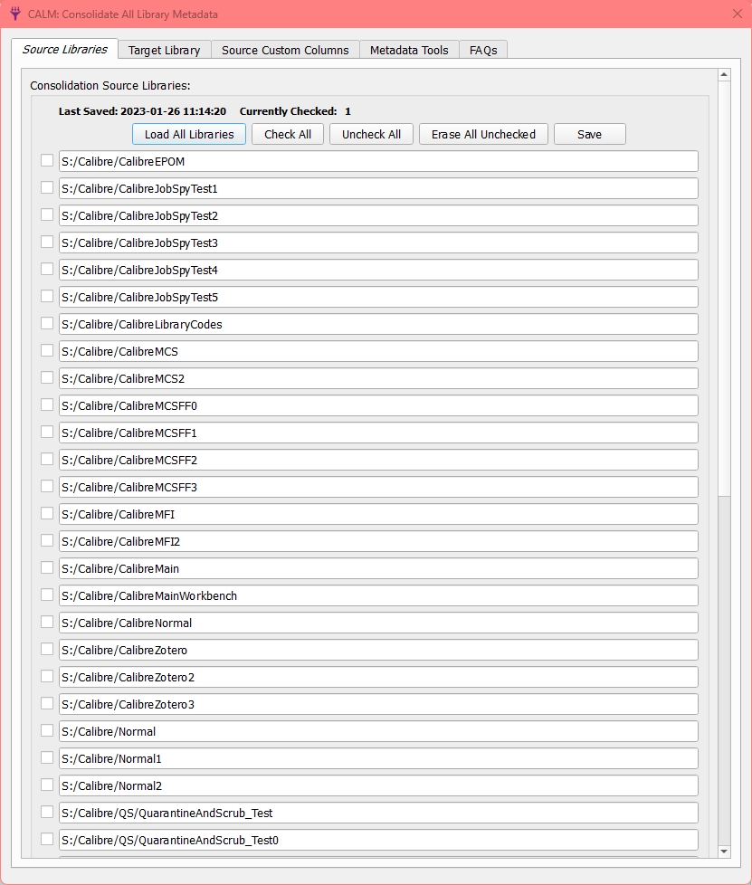

CALM reads the list that Calibre keeps of known Libraries along with the number of times they have been used. CALM loads the Source Library Tabs automatically when the pushbutton is clicked using that saved list, sorting descending by the usage count. See the attached example image.
You can find that file via grep in the Calibre configuration directory looking for text of one of your Library's name and path.
Question: did you manually key the Source Library name? Or use the pushbutton?
Also, I still have not seen a full, detailed debugging log at all. Only your excerpts, including the odd asterisks. Please post a full, real log, and let me review the real thing, unedited. Thanks.
DaltonST
