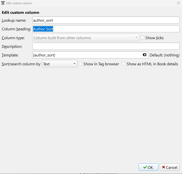

Why not hide Author(s) and display Author Sort then?
AFAIK you can't display Author Sort in the library list. Do you know a way?
Old 12-07-2022, 06:41 PM   #50
Posts: 55,627
Karma: 182544312
I created a custom column to display the Author Sort. See the image. It can be referred to as #author_sort.
