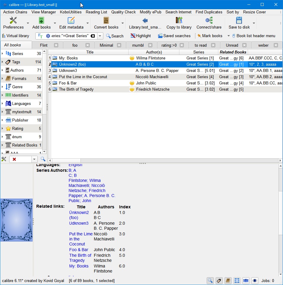

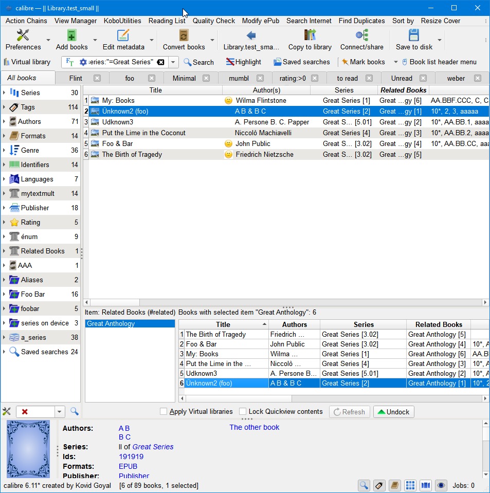

Riffing a bit on BetterRed's method, what I would do: Create a custom series column (example: #related) to relate the anthologies. Make the anthology have index 0. The rest are in book order.
I now have three choices:
  • Use Quickview to browse the books in the anthology. Show Quickview then click in the Related Books column in the booklist. You can now navigate between the related books in the Quickview pane/window. Double-clicking in a related books cell will select that book in the booklist.
    Example screen capture:

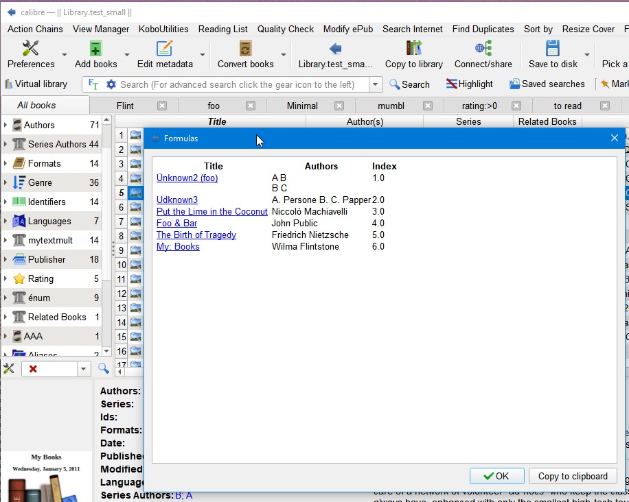

  • Compute "show" links and put them in a custom "column made from other columns" that shows in book details. Example: #related_links. Clicking on the link will select that book in the booklist.
