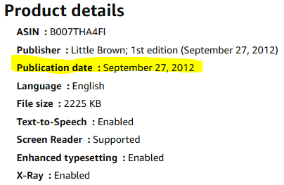

To be clear: there are two parts:
  1. 1.17 still works and downloads books in mobi or azw, except:
  2. Books PUBLISHED AFTER January 03, 2023. Any book published after that date will require a newer version of Kindle for PC and will only download as a KFX with (currently) unbreakable DRM.
Name:	Publication details.PNG
