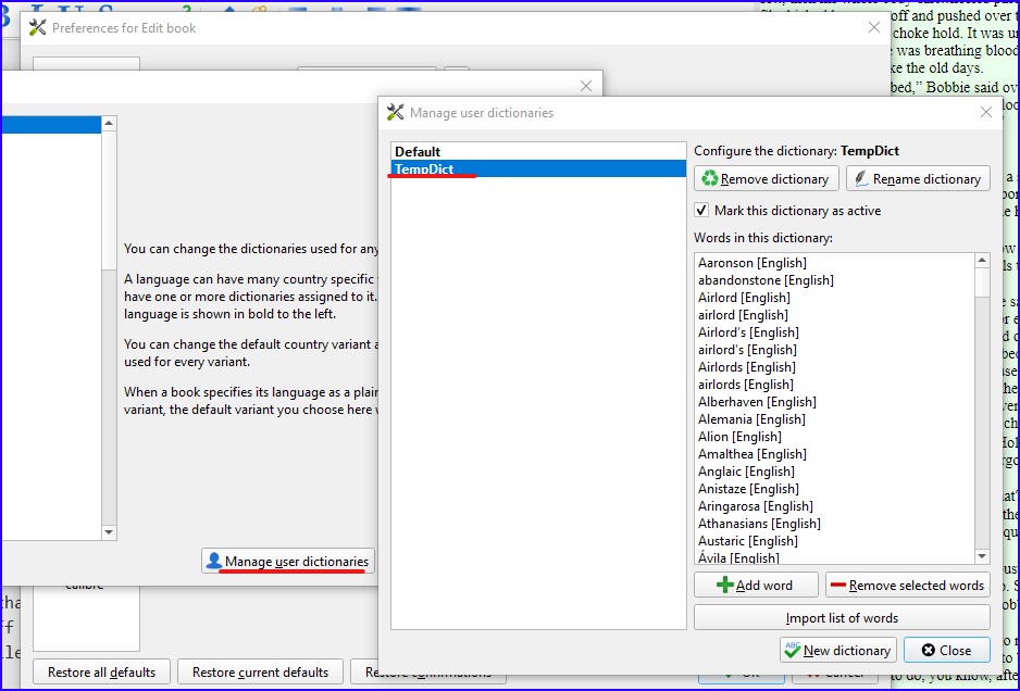

Originally Posted by enuddleyarbl View Post
Unfortunately, I'd previously accepted a lot of those french words as OK in the spellchecker, so, unless I clear that dictionary, I'd be missing them.
I added a second dictionary for exactly this.
I leave the main reference dictionary untouched. Instead I add to the "temp" dictionary. Every now and then I delete the temp dictionary and start again.
