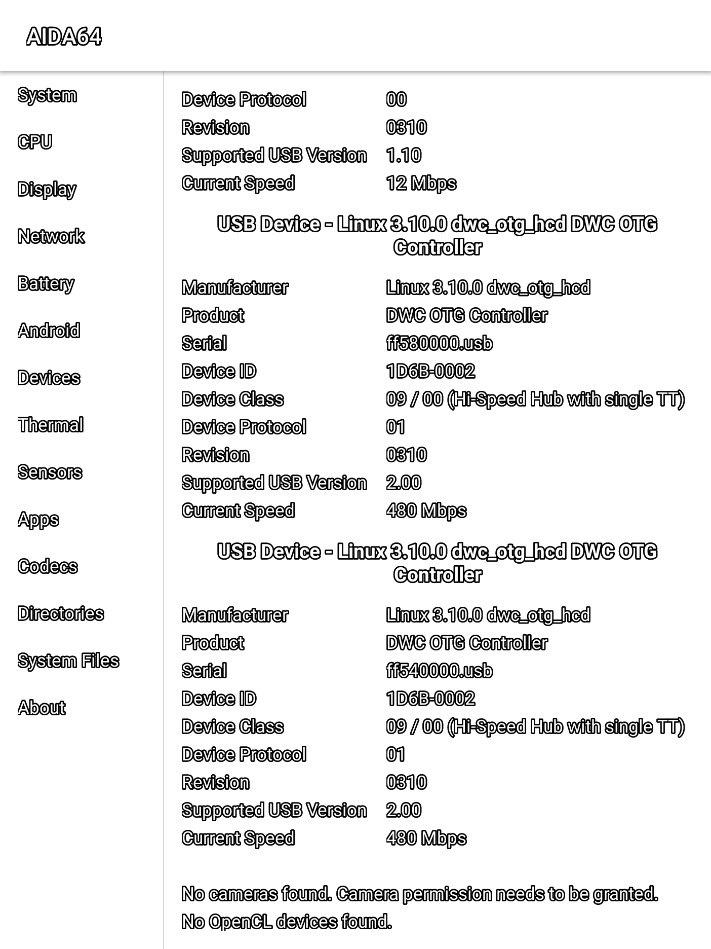

I find that my plug is a usb 2 even is type c.

Old 01-22-2023, 12:08 PM   #11
Renate
Onyx-maniac
Posts: 4,127
Karma: 18764971
Originally Posted by muser View Post
I find that my plug is a usb 2 even if type c.
Ya want me to go blind looking at that stuff???
That's the unspeakable "high contrast text" mode.
You can disable that on a per-app basis. Long click on the app.
There may be a way to turn it off besides my way of disabling all the Onyx stuff.
