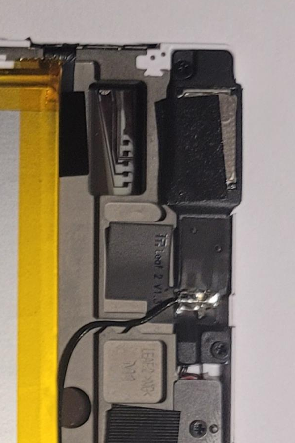

The only thing I noticed that was different between the two models is that the old one had Leaf 2 1.3 on the WIFI molex antenna sticker. The current one has Leaf 2 1.2.All other hardware parts matched.
I took the speaker and the magnets out, they weight 5 grams together. Now I don´t have to worry having the Leaf 2, too close to HDD's. Taking the magnets out wasn't an easy task... They were glued in super tight!
Name:	Wifi antenna.png

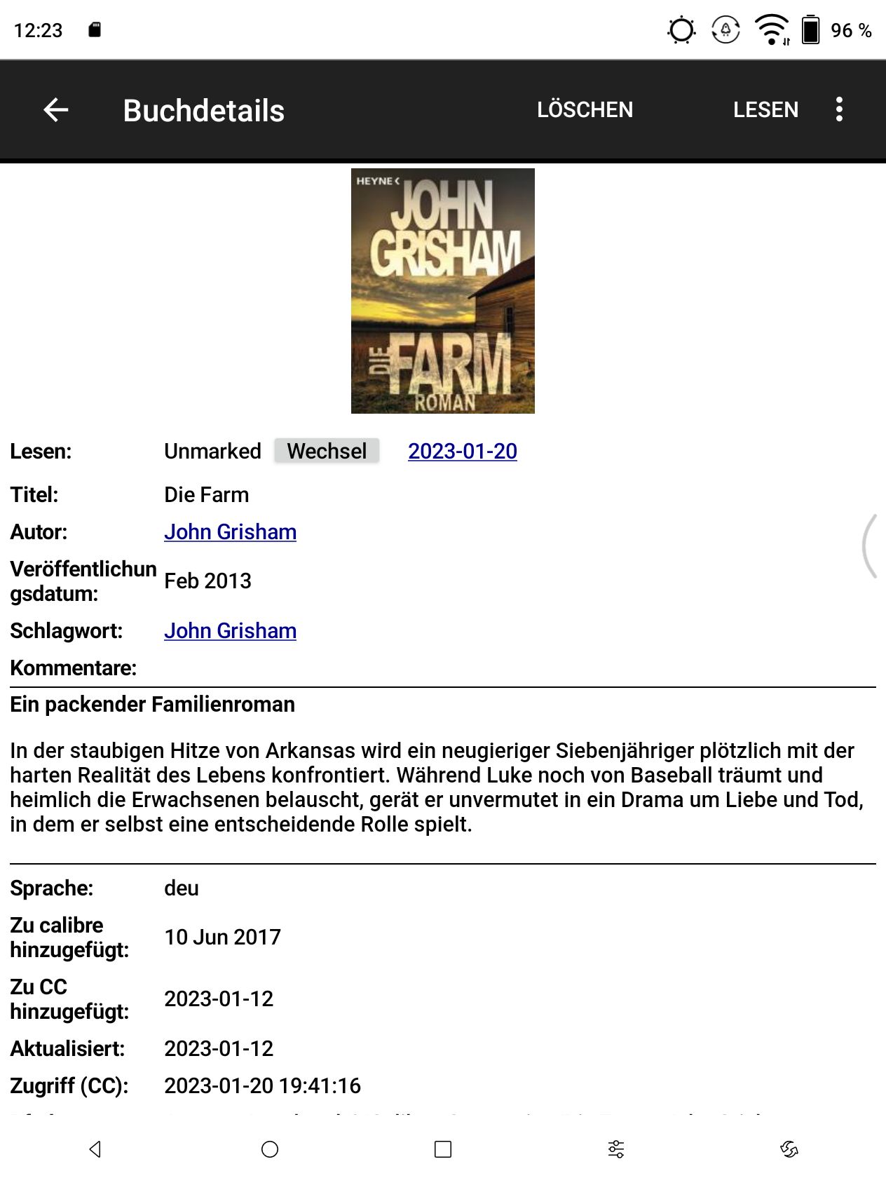

I dont know. I don't use it because it can't or doesn't want to show left-aligned.
And I avoid the Boox library altogether.
I use Calibre on my PC and Calibre Companion on my devices and that's where I see what I need.
