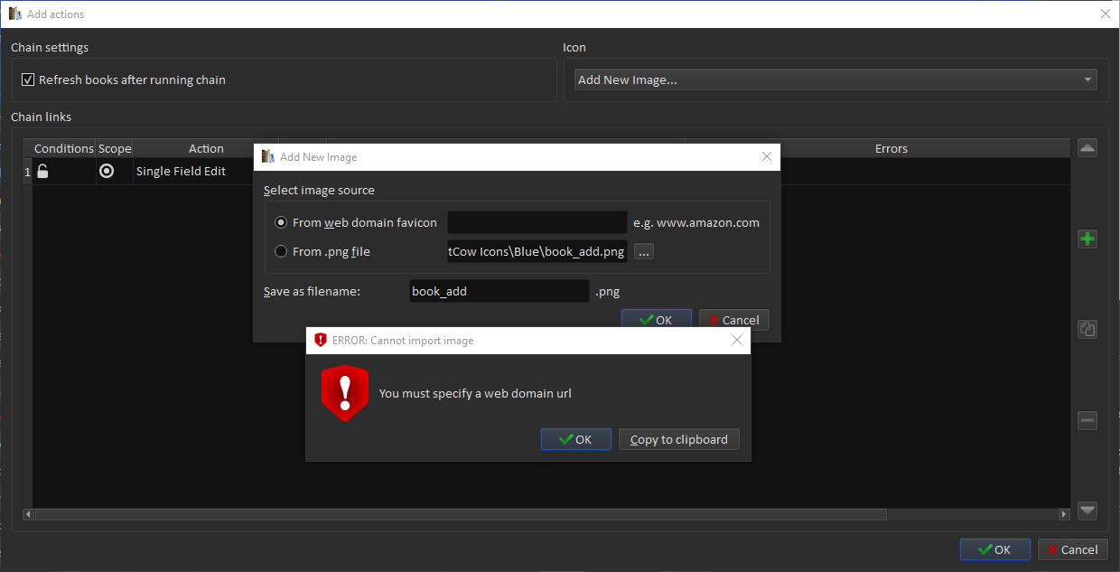

Name:	2023-01-10 20_45_09-Add actions.png
This happens an embarrassing amount of times. Not a huge priority, but could it be possible to automatically select the png option if one is loaded with the file dialog?

Attachment 198931
I planning an overhaul for icon management in the future. There is a similar functionality in calibre columns icons which I will look to see whether is re-usable or not when I have the time for this. So, I am currently no inclined to work on this.
