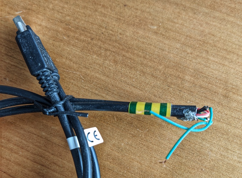

I have found my "edl cable"
I can give it a try, but I have read, that headphone connection on USB-C could interfere. Does Leaf2 support headphones?

There is some effect: Leaf2 looks dead after inserting this edl cable. No change on screen and no reaction to power button. And I can't see any new devices on PC. Only long press on power button restart device.
I'm rather reluctant to experiment with this rusty cable. I have fond, that there is USB-C version of cable, see here (I'm not sure if I can public links yet):
https://www.mobilerdx.com/2022/12/how-to-make-qualcomm-modified-type-c-edl-cable-latest-security.html

Using the EDL terminals inside the device you have to keep pressing the power-button while shorting the terminals until you hear/see it connect in Windows. Sometimes it goes into 900e mode instead of 9008 mode.
Thanks for testing. I'll make my own cable for further testing.

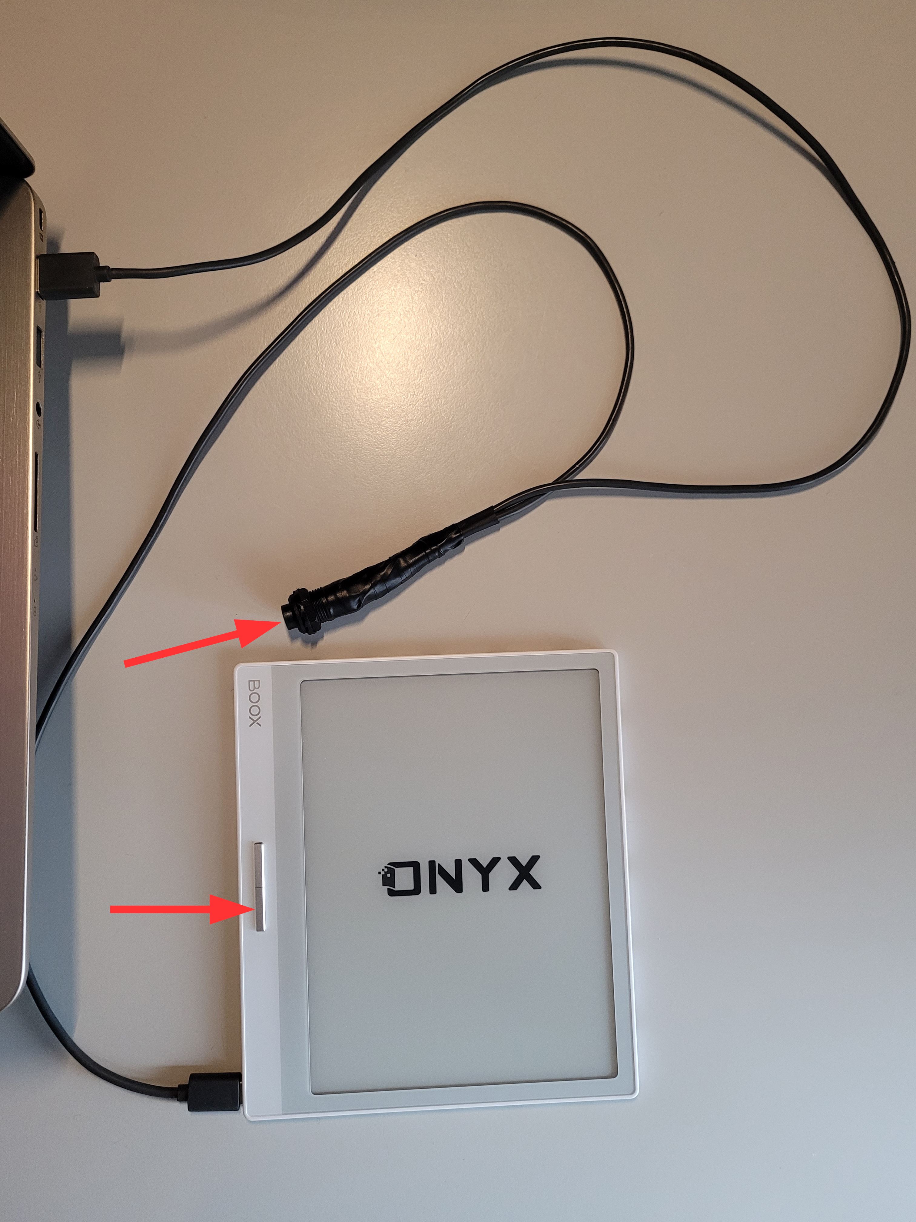

I only understood half of what I posted above but I can confirm it works.
Holding the power button + volume down + the Qualcomm cable button on boot (or before rebooting) brings the device in Emergency Download Mode (EDL). So, in case of a brick you don't need to open the device.
Now that we know the ways to access EDL, we just need to find a loader so we can read/write to it.

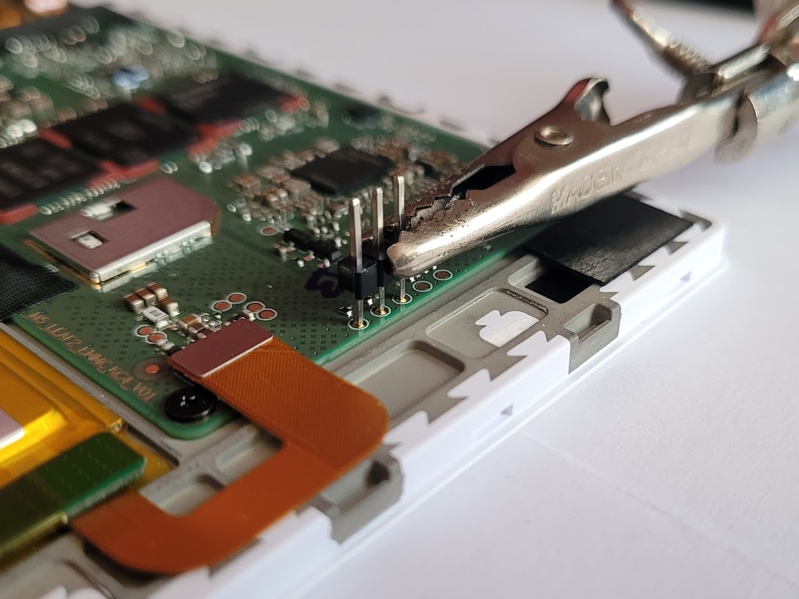

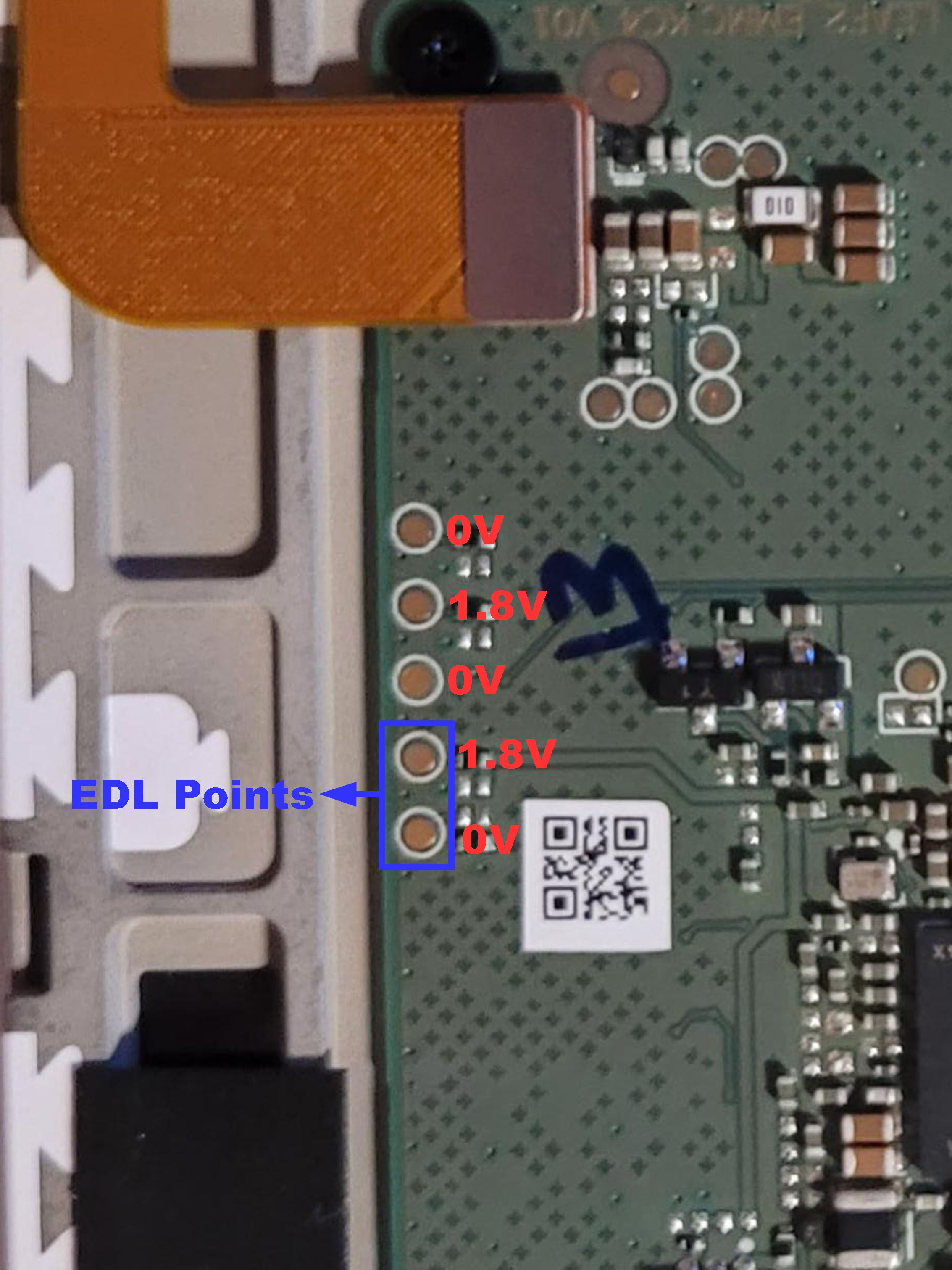

Can you get the device into Recovery or Fastboot? Press the power-button 7 seconds on boot, then tap it 5 times to get into recovery. (You might have to try a few times, it's quite tricky)
If you manage to boot Fastboot, you can try switching the active boot partition. That fixed a bootloop for me. (Thanks @popej)
fastboot  --set-active=b
If you really can't get into Recovery or Fastboot you can get the device in 9008 mode by one of two methods. You won't be able to restore the device (YET) because we haven't found a loader to Firehose the device.
Tip: Renate has made some amazing tools for troubleshooting and EDL. I recommend having her USBlog tool open to see when the device is being detected.
  1. Option 1: You can make a Qualcomm-EDL cable. You just need an old USB-C cable, cut it in half and solder a Momentary Push Button in between the green and black wire. There are a lot of tutorials on Youtube on how to make such a cable. Alternatively you could buy the cable of course.
    Once you have the cable push Power + Volume Down + EDL-Cable button on boot. (Or reboot it with the 3 buttons pushed) This will most likely also take a few tries but eventually you'll get it into 9008 mode. (see first picture in the attachment)
  2. Option 2: You can open the device and short the EDL pads while booting the device. See the second picture in the attachment for the locations.

I tested the loader but I get:
Sending 000ac0e100000000_7be49b72f9e43372_fhprg_asus_peek.bin   0%
End transfer returned error 12
I also tested the UART Serial-USB on a Raspberry Pi first to confirm it's working, then switched the 3,3v to 1,8v and tried it on the Leaf2. But I don't get any output.
This is how I wired it:
  • TX > RX
  • RX > TX
  • Ground > Ground
Maybe the RX trace needs to be bridged somewhere first?
Should it give output while booting or only in EDL-mode?
Name:	Leaf 2 - UART pin headers.jpg
ID:	198308   Click image for larger version
Name:	Leaf 2 - UART connected.jpg
