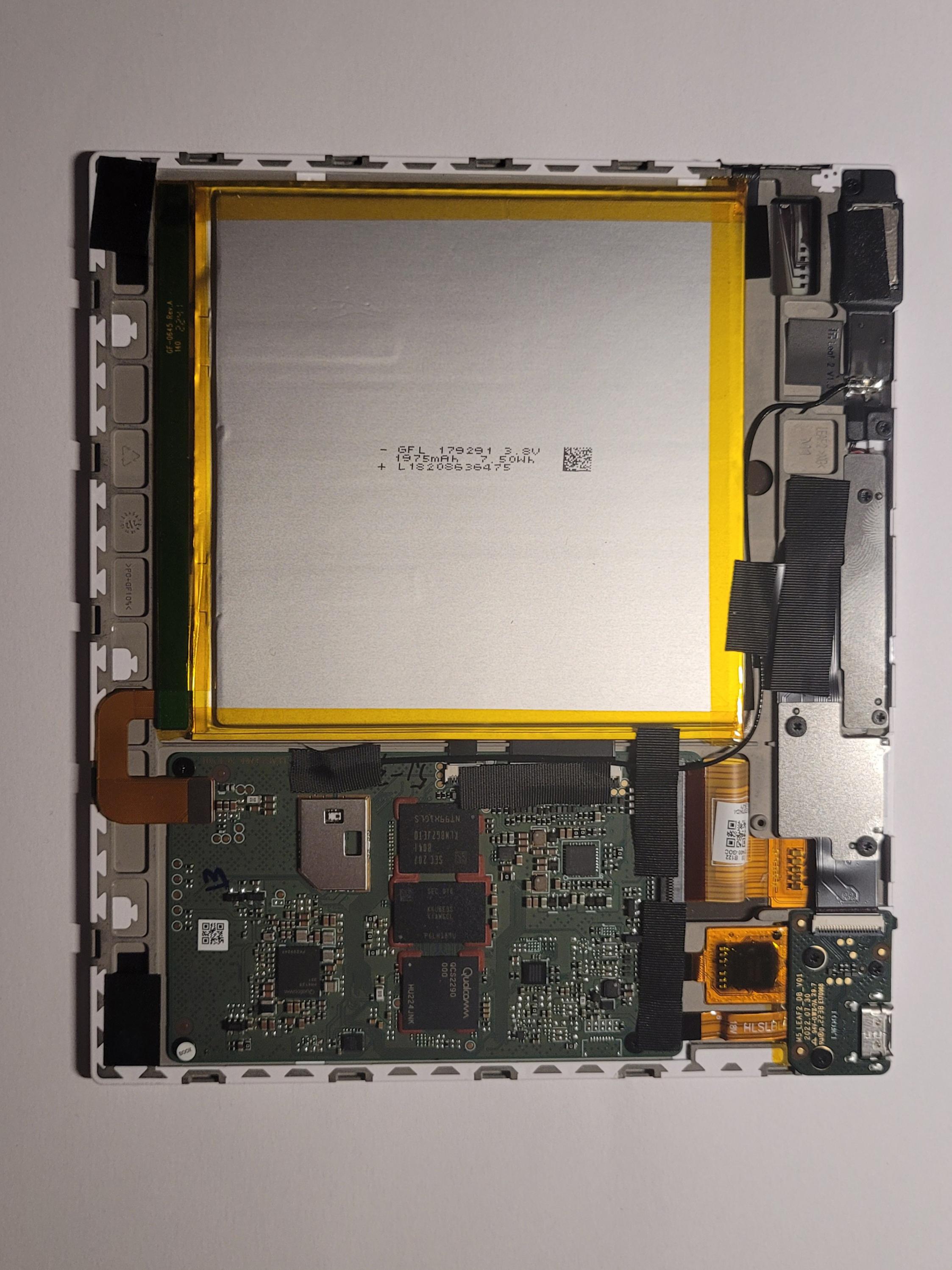

The chip is a QCS2290 000
Well, you've hit the Rosetta stone!
Now we know that a QCS_AGATTI is a QCS2290.
Here's one more Firehose loader to try: https://github.com/bkerler/Loaders/b...4665_FHPRG.bin
I'm confused over the two big FPC (orange) cables.
Onyx seems to be more secretive here. Still, the 5 dots on the bottom edge of the board look good for UART & EDL mode. Just don't short them!
Do you want to be a beta tester for a Leaf2 custom recovery?
