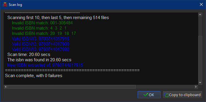

Agh! Any chance of changing this blue for dark mode?
No chance of it being changed by me, that is a calibre issue with it’s logger and different colours it sets for debug, warn etc.
The green is terrible too. Not as bad as the blue, but still too dark.
Try this
Also see this
