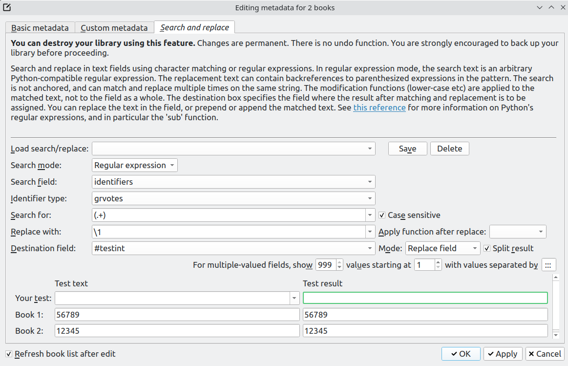

Hello!
I have this problem: https://www.mobileread.com/forums/sh...d.php?t=350600
So in short, I have two identifiers, grvotes and grrating, each in a "Column built from other columns" column which I want to move into "Floating point numbers" columns so that the goodreads rating and votes display as a value in calibre-web instead of as identifiers.

You don't need action chains to accomplish this. You can do with calibre's batch edit metadata by selecting all the books you want to edit > right click > edit metadata > edit metadata in bulk > copy the parameters in the screenshot below.
Note: In the screenshot below I move to a new column called #testint. Replace that with the name of the column you want.
Thank you, it works perfectly!

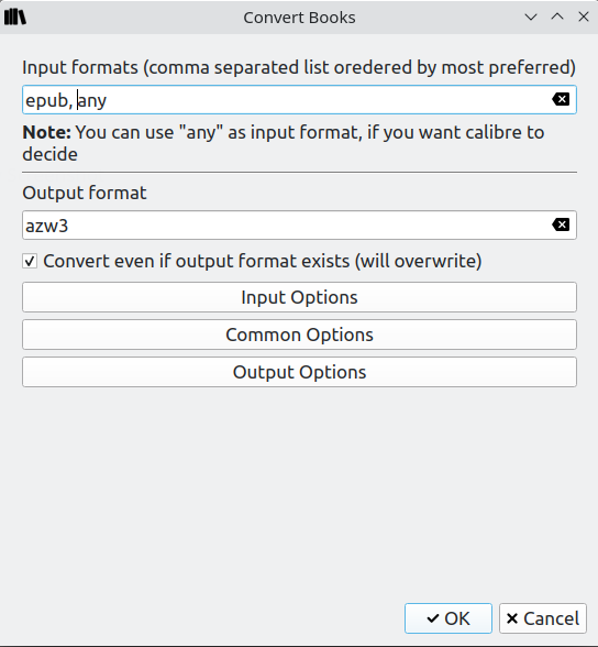

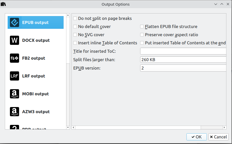

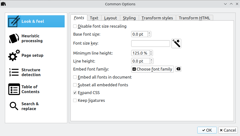

New test version
  • Update: Add "Convert Books" action.
This action gives the user the ability to configure the convert options as well as the input and output format. The input format can be specified in a comma separated list of formats in order of preference. You can also use calibre's template language to make the input/output format change per book as well.
You can download this beta from here

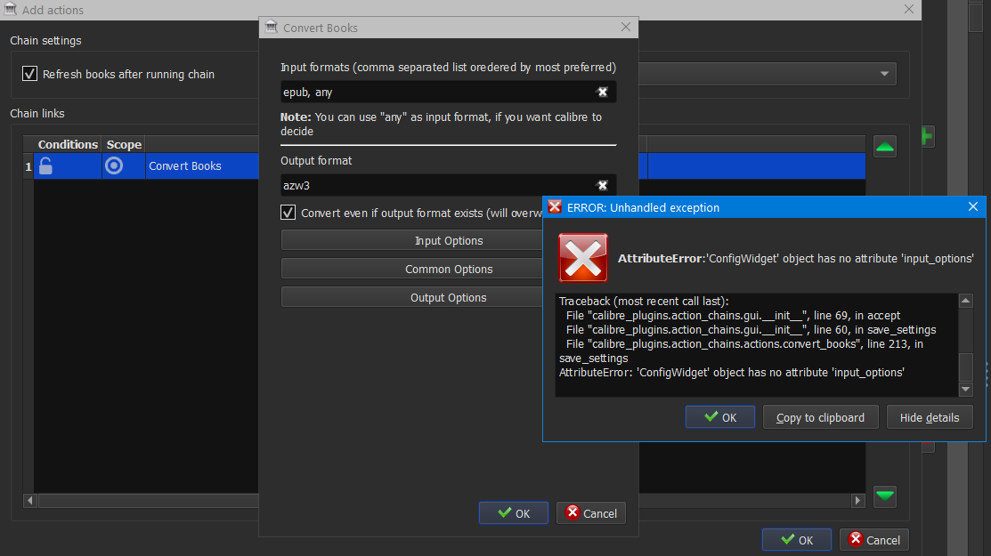

Hi capink! Just gave it a try and I'm getting this, upon clicking any of the options buttons:
Name:	MWSnap0906 2022-12-04, 15_05_48.png
Comfy.n is online now   Reply With Quote
Old 12-04-2022, 01:13 PM   #967
ownedbycats
Custom User Title
ownedbycats's Avatar
Posts: 11,816
Karma: 83109135
Join Date: Oct 2018
Same here.
calibre, version 6.9.0
ERROR: Unhandled exception: <b>AttributeError</b>:'ConfigWidget' object has no attribute 'input_options'
calibre 6.9  embedded-python: True
Windows-10-10.0.19045-SP0 Windows ('64bit', 'WindowsPE')
('Windows', '10', '10.0.19045')
Python 3.10.1
Windows: ('10', '10.0.19045', 'SP0', 'Multiprocessor Free')
Interface language: None
Successfully initialized third party plugins: DeACSM (0, 0, 16) && DeDRM (10, 0, 2) && Action Chains (1, 18, 1) && Baen (1, 1, 0) && Barnes & Noble (1, 4, 0) && Comments Cleaner (1, 8, 0) && Count Pages (1, 12, 0) && Embed Comic Metadata (1, 6, 4) && EpubCheck (0, 2, 4) && EpubMerge (2, 15, 0) && EpubSplit (3, 5, 0) && Extract ISBN (1, 6, 0) && FanFicFare (4, 18, 0) && Fantastic Fiction (1, 6, 0) && Favourites Menu (1, 3, 0) && Find Duplicates (1, 10, 7) && Generate Cover (2, 3, 0) && GetFileName (0, 2, 0) && Goodreads (1, 7, 1) && Import List (1, 9, 0) && Job Spy (1, 0, 196) && Kindle hi-res covers (0, 5, 0) && KindleUnpack - The Plugin (0, 83, 1) && Kobo Books (1, 9, 2) && Kobo Utilities (2, 16, 6) && KoboTouchExtended (3, 6, 3) && Last Modified (0, 8, 4) && Manage Series (1, 5, 0) && Modify ePub (1, 8, 1) && MultiColumnSearch (1, 0, 95) && Obok DeDRM (7, 2, 1) && Open With (1, 8, 0) && Overdrive Link (2, 53, 0) && Quality Check (1, 13, 3) && Reading List (1, 14, 0) && Search The Internet (1, 10, 0) && SmartEject (2, 5, 0) && Standard Ebooks (1, 0, 0) && Sum Column (0, 3, 1) && View Manager (1, 10, 2) && Walk Search History (1, 5, 3) && Overdrive Link Metadata Source (2, 53, 0)
  File "calibre_plugins.action_chains.actions.convert_books", line 179, in _on_input_button_clicked
AttributeError: 'ConfigWidget' object has no attribute 'input_options'
ERROR: Unhandled exception: <b>AttributeError</b>:'ConfigWidget' object has no attribute 'common_options'
Python 3.10.1
  File "calibre_plugins.action_chains.actions.convert_books", line 193, in _on_common_button_clicked
AttributeError: 'ConfigWidget' object has no attribute 'common_options'
ERROR: Unhandled exception: <b>AttributeError</b>:'ConfigWidget' object has no attribute 'output_options'
Python 3.10.1
  File "calibre_plugins.action_chains.actions.convert_books", line 186, in _on_output_button_clicked
AttributeError: 'ConfigWidget' object has no attribute 'output_options'

OK, I uploaded a new beta.
capink is offline   Reply With Quote

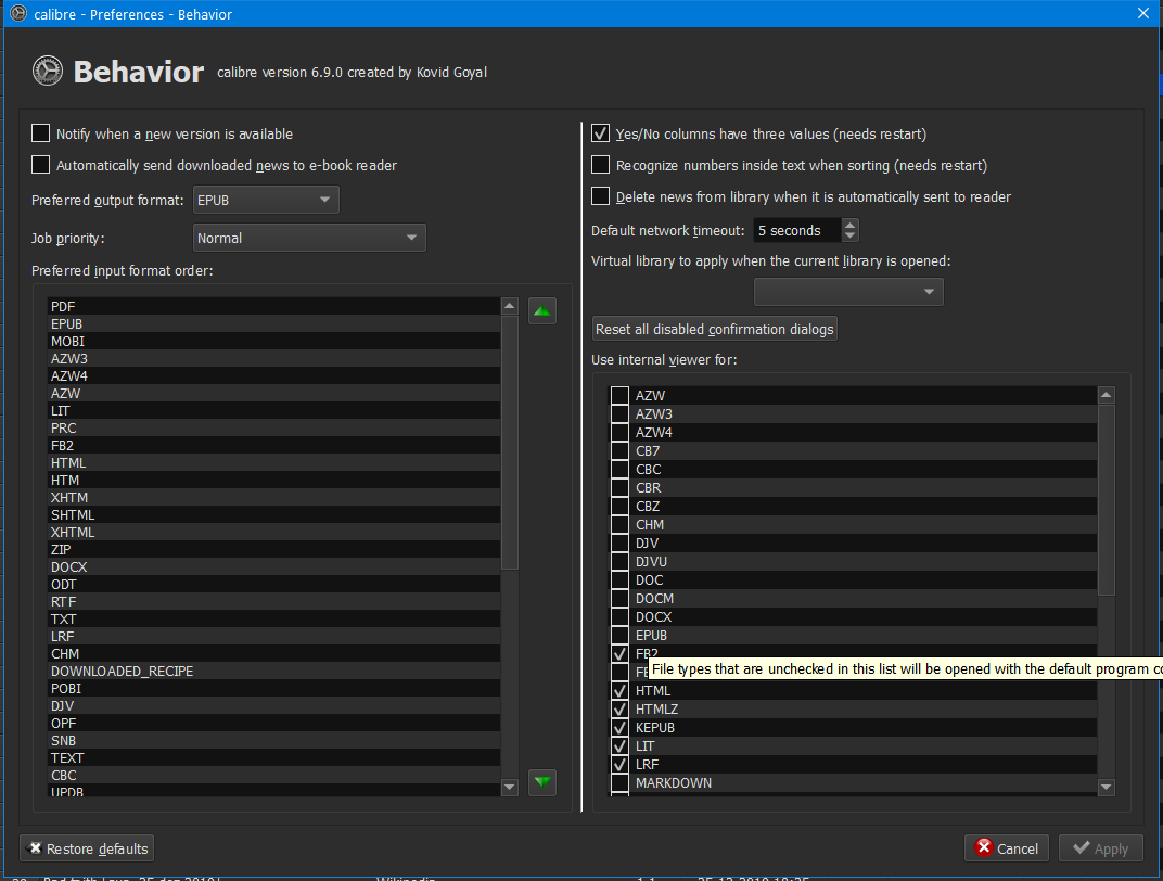

I wonder if it's possible to make an action to toggle default internal viewer on the fly, I mean, to change this setting:

Old 12-04-2022, 02:12 PM   #972
capink
capink ought to be getting tired of karma fortunes by now.capink ought to be getting tired of karma fortunes by now.capink ought to be getting tired of karma fortunes by now.capink ought to be getting tired of karma fortunes by now.capink ought to be getting tired of karma fortunes by now.capink ought to be getting tired of karma fortunes by now.capink ought to be getting tired of karma fortunes by now.capink ought to be getting tired of karma fortunes by now.capink ought to be getting tired of karma fortunes by now.capink ought to be getting tired of karma fortunes by now.capink ought to be getting tired of karma fortunes by now.
Posts: 1,223
Karma: 1995558
Join Date: Aug 2015
Attachment 198177
That's what the open with action is for.

Old 12-04-2022, 02:26 PM   #974
Comfy.n
want to learn what I want
Posts: 2,304
Karma: 7990245
Join Date: Sep 2020
Device: Libra Colour
I couldn't figure a way to apply the Open With action to cases like this:
when doing FTS searches, my preferred viewer is not the system default (Sumatra). So I wanted to have Calibre default to open with internal viewer before doing FTS.
I apologise for quoting myself here
https://www.mobileread.com/forums/sh...47&postcount=5
I think I just wanted a quick toggle for setting Calibre's as the current internal viewer for EPUB, for instance, before doing FTS searches. But there are a few more use cases I don't recall atm...
edit: a quick toggle for setting the internal viewer to open EPUB formats, for instance...
Old 12-04-2022, 02:31 PM   #975
capink
Posts: 1,223
Karma: 1995558
Join Date: Aug 2015
There is a plugin called quick preferences. I have not used it, so I am not sure it fits what you want to do. Give it try and see if does what you want.
Anyway, if you are going to use Action Chains to toggle the setting, you might as well use it to open in whatever editor you want (by binding different editor chains to different keyboard shortcuts).
