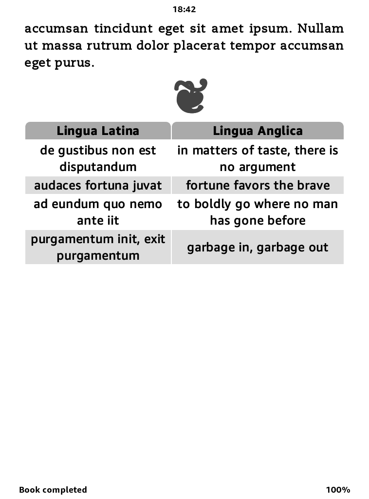

Old 11-24-2022, 01:56 PM   #20
Doitsu
Doitsu's Avatar
Posts: 5,934
Karma: 24259515
Device: Kindle PW2
Originally Posted by Oxford-eBooks View Post
What I'm currently finding is that I have a table with shaded backgrounds on alternate rows.
You could also create zebra striping with pseudo selectors not listed in the Kindle Publishing Guidelines.
For an example, see the screenshot of a KF8 book taken with my old Paperwhite 2. The epub2 source file is here.
Hilariously: All but ONE of the icons are found in a font that I embedded, but one of them had to be taken from a different font and wouldn't render. Would have gotten away with it ALL if it hadn't been for that one pesky glyph!
What, exactly, are the symbols (and tables) you're trying to reproduce?
(Show us images of the PDF pages.)
Oh, the shaded table rows work just peachy on KP3 not a problem AT ALL.
A "shaded table" with transparent PNG? That just sounds like it's asking for trouble once users fiddle with their settings.
(I hate websites that do that with my color overrides.)
(Also, images-of-tables... poor idea. Better to do actual HTML tables. See my detailed topics below.)
You could also create zebra striping with pseudo selectors [...]
Yes, that is also a possibility.
