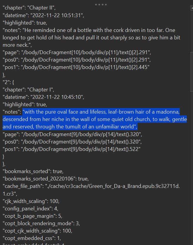

I've had this thread bookmarked for ages, but have only just installed the plugin - oh frabjous day! Thank you so much for your work on this, it's areal boon. I have a question, and I hope it's not one that I've missed the answer too:
In the Annotations column, the data looks as shown in the screenshot. Is there any way to have just the notes showing, e.g. only the highlight shown in blue, without all the other data?
Did you map "Bookmarks column" to that column? Because it looks more like the "Raw sidecar column". The bookmarks column will look like this:
- in CHAPTER VI. Pig and Pepper <!-- datetime: 2020-11-16 18:52:11, page: /body/DocFragment[8]/body/div/h2/text()[1].0, chapter: CHAPTER VI. Pig and Pepper -->
- “You!” said the Caterpillar contemptuously. “Who are you?” <!-- text: Higlight with note: Page 48 “You!” said the Caterpillar contemptuously. “Who are you?” @ 2020-11-16 18:51:04, page: /body/DocFragment[7]/body/div/p[12]/text()[1].0, chapter: CHAPTER V. Advice from a Caterpillar, highlighted: True, datetime: 2020-11-16 18:51:04, pos0: /body/DocFragment[7]/body/div/p[12]/text()[1].0, pos1: /body/DocFragment[7]/body/div/p[12]/text()[2].1 -->
Still with some metadata, but easier to filter because it's wrapped in an HTML comment.
I do have an open TODO to add an option to customize the way these highlights are formatted, but haven't gotten around to it: https://todo.sr.ht/~harmtemolder/kor...libre-plugin/3
Thanks, that fixed it!
