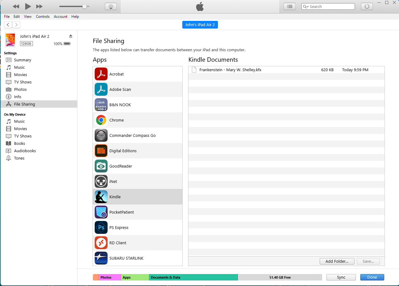

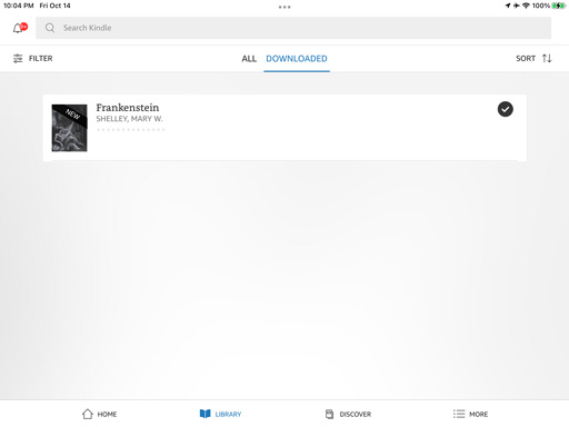

Originally Posted by ccszotyi View Post
I read the first post with some instructions for IOS devices, but it is not clear how the Kindle app would open the files once I transfer them to my device.
In iTunes after connecting your iPad select the Kindle app within File Sharing. Drag and drop the KFX file there. The book will then show up in the Library view of the Kindle app. (See attached images.)
ID:	197163   Click image for larger version
