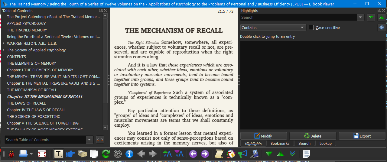

This issue got me curious so I ran the native Calibre Polish tool in one book, just to take a look:
Name:	hyphenation on, MWSnap0871 2022-11-18, 22_49_52.png
vs
Name:	hyphenation off, MWSnap0870 2022-11-18, 22_48_29.png
On first glance, I don't see much difference... Is there, perhaps, an optimization for reading in other languages, with hyphenation?
