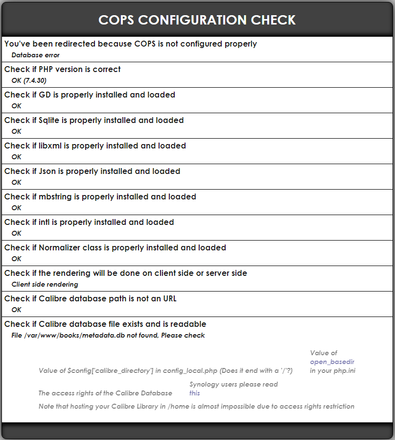

COPS error/No metadata.db file on Raspberry Pi
Hello, I've read through some similar situations on configuring RPi installations but there's nothing I've found that can help me progress hence my plea here. Total CLI noob so go easy.
I'm trying to set up the COPS through a domain so I can access my ebooks on any device anywhere. I've got the domain set up, SSL certs installed, Calibre installed I believe correctly but I'm now confronted with the following situation when I access the domain when trying to run and configure my setup (see attached file - COPS error)
I've put a couple of ebooks in the folder and as far as I understand the calibre database file is generated as a result of the presence of books. Now what I'm unsure about is that whether I somehow need to run Calibre first to generate the file and then run the COPS bit but I'm at a loss as how to do it.
  • Value of $config['calibre_directory'] in config_local.php (Does it end with a '/'?) - yes it does, i checked that
  • Value of open_basedir in your php.ini - unsure of where this is
  • The access rights of the Calibre Database - for the purposes of troubleshooting I've set it to 777 to remove this as an issue
So yeah I'm kinda stuck. Any pointers would be greatly appreciated.

@simonbuttress
How does all this work? simple if you know it. I will try to explain.
1 - Download calibre on a PC (Windows/ Mac or Linux) https://calibre-ebook.com/
2 - add e-books to calibre through the gui menu. Then close calibre.
3 - copy the directory with the calibre database and the e-books in subdirectories to your Raspberry Pi.
4 - point COPS to the directory where you copied point 3 to.
5 enjoy COPS
Do not forget to protect your e-books from unwanted visitors with a password.

Old 11-11-2022, 06:05 AM   #1883

What I did was install Calibre on my local machine and add my books using the program interface, then upload the complete library to my remote machine. This transfers the missing file as well and worked on my remote headless server. Alternatively, if your remote server has a gui then you could run Calibre on it and add the books through the calibre interface. This would generate the missing file.

Mint. Absolutely mint. I'll be trying that tonight when I finish work. Thank you both so much for your guidance.

Helllo, it worked. Love you guys, thank you!!
