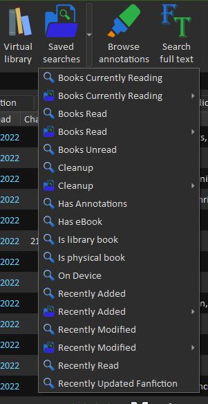

Built-in toolbar option. You'll need to run from source or wait for the next update.
EDIT: Here's a screenshit:
Attachment 197240
assuming that this is the build‐in «saved searches», how are you able to add folder to it?
Go to Preferences > Look & Feel > Tag Browser > Hierarchy and searching, and select "Saved Searches."
Then create a saved search named something like foo.bar — the period is what's important. 'foo' will appear as a folder. (If you also have a 'foo' search, it'll appear as a separate entry - see the 'recently added' entries on my screnshot.)
The "improved" saved searches menu does hierarchy based on internal periods regardless of whether or not it is chosen in Tag browser hierarchy. The tag browser saved searches display does hierarchy only if it is chosen.
I am waiting for someone to complain about the inconsistency.

Thanks for quick reply. Now I am able to create something looking like a folder. ... But (sorry to ask) how to put/move more searches into it?
I got it. It must be same first name, as usual by hierarchy.

If you want to add searches to a 'foo' folder you can rename them to 'foo.my search'.
Since you brought this up: I have been debating with myself this case. Given a search "foo" and a hierarchy "foo.something", where should be "foo" search go?
This is what it does today. The "foo" search is on the upper level, followed by a menu containing the "something".

Here is an example where the "foo" search goes inside the menu at the top. It has a "search" icon and is suffixed by the word "Parent" to distinguish it from a possible search "foo.foo"

And here is an example where there is no "foo" search (in this case "zzz").

I really don't know which is better. Opinions?

That was also something I thought of (and then forgot before I made a ticket ). I like the second option - if feasible, it would look nice if it was divided from the 'subsearches' with a divider.
Like this?

Here is what the saved search menu would look like for the same saved searches as above, if I made the menu honor the hierarchy setting and then turned off hierarchy.

Personally, I find the current behavior is very good.
I think that the "foo (parent)" requires a little gymnastics to arrange and retrieve the wanted Search, while "A Search does not overlap with a folder of the same name" is very more simple to understand and work with.
Thanks. This well expresses the worry I have: putting the "parent" into the "child" menu introduces a semantic inconsistency, one that I tried to overcome with the word "(parent)". The current implementation avoids that by separating the search from sub-searches. There is also an issue with translations, where "parent" meaning a higher item in the hierarchy might be hard to express well and succinctly. And then there is @Katja_hbg's point (I think): that the parent/child relationship in the hierarchies isn't a graph.
On the other hand, the current implementation takes more menu space -- in effect two lines per search for searches that exist as bare and with children. This is the situation @ownedbycats is seeing.
I am leaning toward keeping it how it is, with the exception of following the "hierarchical" specification in the tag browser.

Like this?
Yes, that's what I was thinking
un_pogaz also makes good points tho
