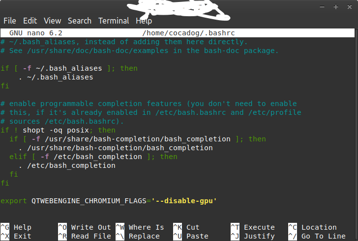

Old 11-06-2022, 03:33 PM   #6
gbm
Posts: 2,305
Karma: 8891824
Open a terminal
type in:
sudo editor ~/.bashrc
enter password
go to the bottom of the file using the down arrow.
type in:
export QTWEBENGINE_CHROMIUM_FLAGS='--disable-gpu'
Name:	Screenshot from 2022-11-06 14-22-35.png
save file using ctrl shift ^X
type y return
reboot.
bernie
Thank you very much. That worked!
