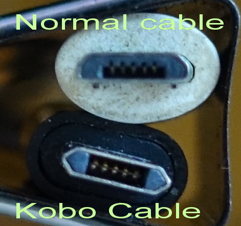

Hi,
I accidentally found my Forma micro USB cable is different from my other normal USB cable. Its shape enable it to insert into the reader socket both ways. I tried it on my Forma and found the reader is found by the computer whether it is inserted either way. I am glad it can be used as a type-c connector.
The cable aslo work on my Aura HD.
Thanks
Allen

Hi,
Additional search found this type of cale is already available in amazon as Reversible Micro USB Cable.
Thanks.
Allen

Yes, you can buy those. They are more fragile. A proper spec non-reversible cable is more reliable.

Quoth,
There are a lot of information. Thanks. Kobo do use type C connector in their new ereaders.
I search the name "reversible mirco USB cable" and found they are here quite a while. However my Kobo cable is the only reversible cable I come across so I suspect they are not so common. At least I can use this cable without looking at which side should be upward, a little convenience that I enjoy.
