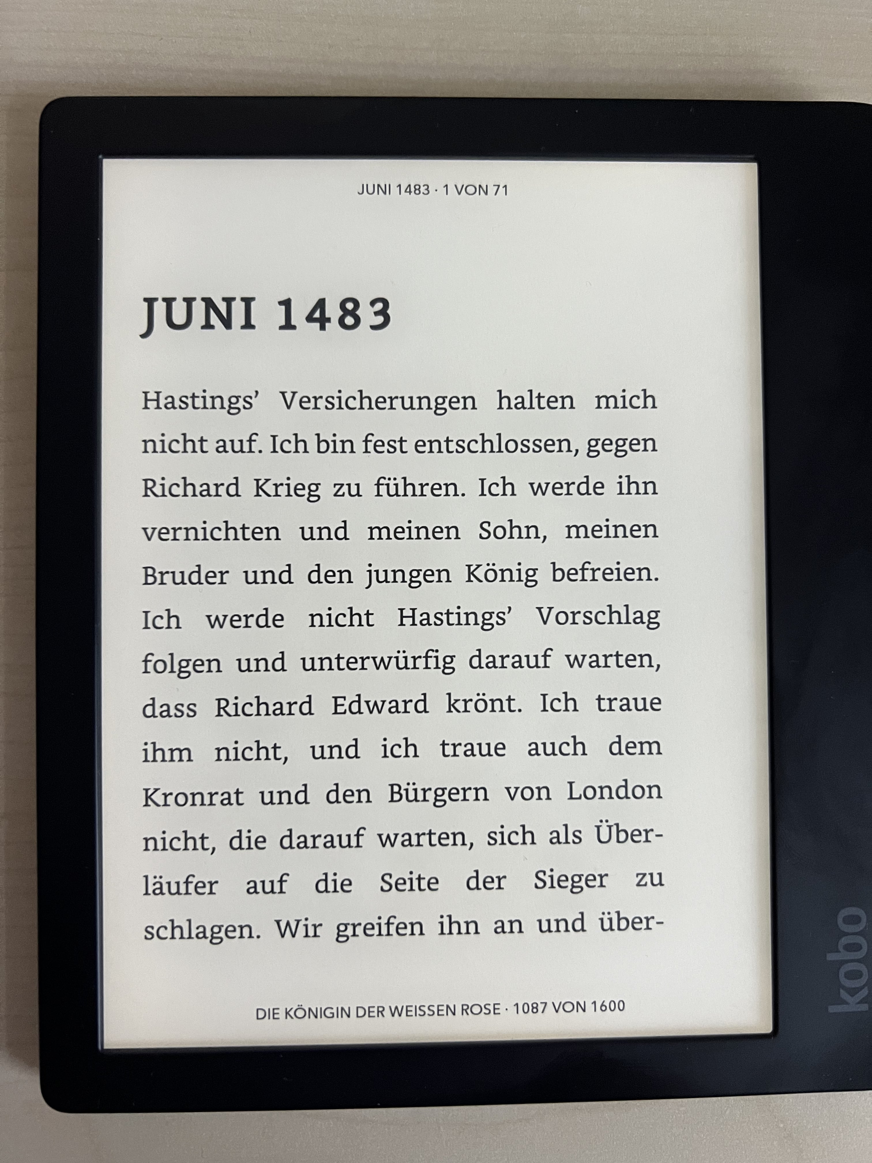

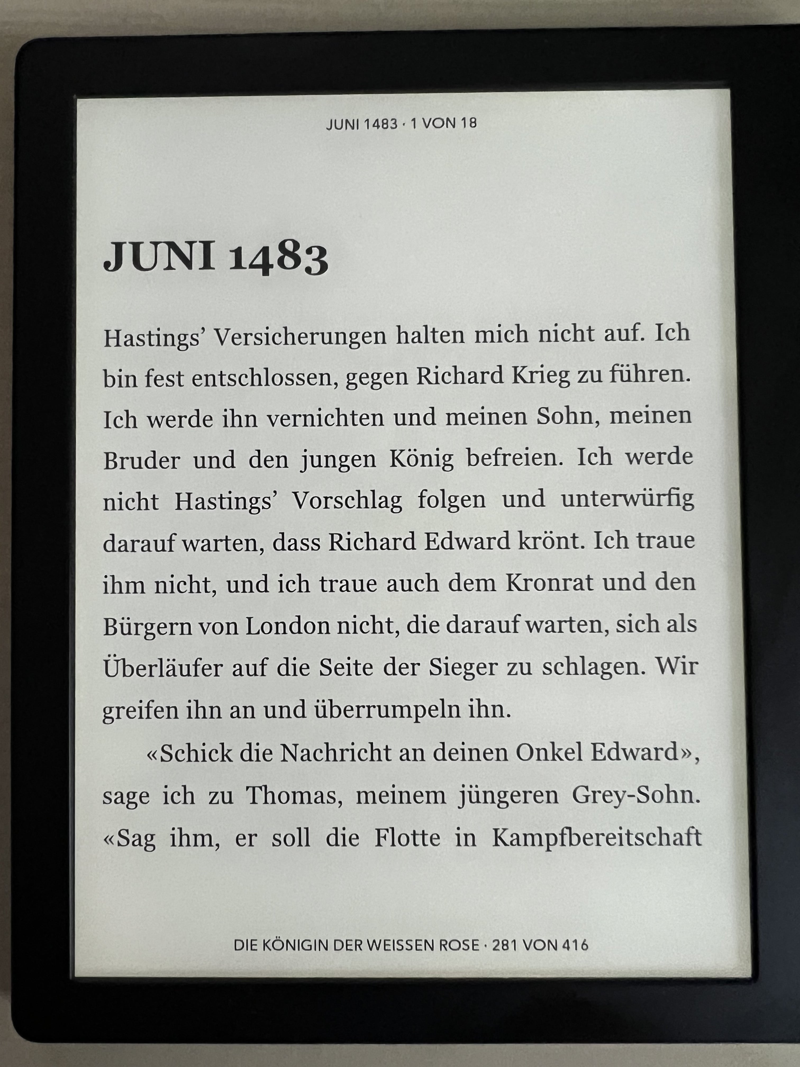

I’ve just bought a Kobo Libra 2. I send my Epubs to the device with the Kobo Touch Extended Plugin. When I open the e-book in the Libra 2, the text is oriented on the left boarder but between the text and the left boarder is a big gap of approx 4cm. If I send the book as the original ePub, the text is full screen. Do you know how to solve the problem?
2 pictures to show you what I mean. Epub and Kepub.
All books or only this one book?
