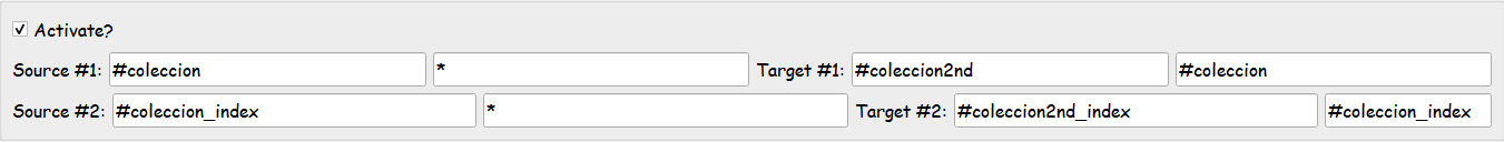

Update custom column based on another custom column
Hi.
I'm try to move al the books in a #colection to a #2nd_collection.
Is it posible to use this function of your plugin using in the destination no fixed values instead of the name of the future column?
For example i'd like to move
#colection, value=* -> colection2nd updated by #colection
#colection_index, value=* -> colection2nd_index replaced by #colection_index
As you could see i dont want fixed values, i would like the values of the othe column.
Thanks
killo3967 is offline   Reply With Quote
Old 10-31-2022, 04:59 PM   #743
Posts: 82,233
Karma: 150871427
Originally Posted by killo3967 View Post
Hi.
Thanks
Here is the image.

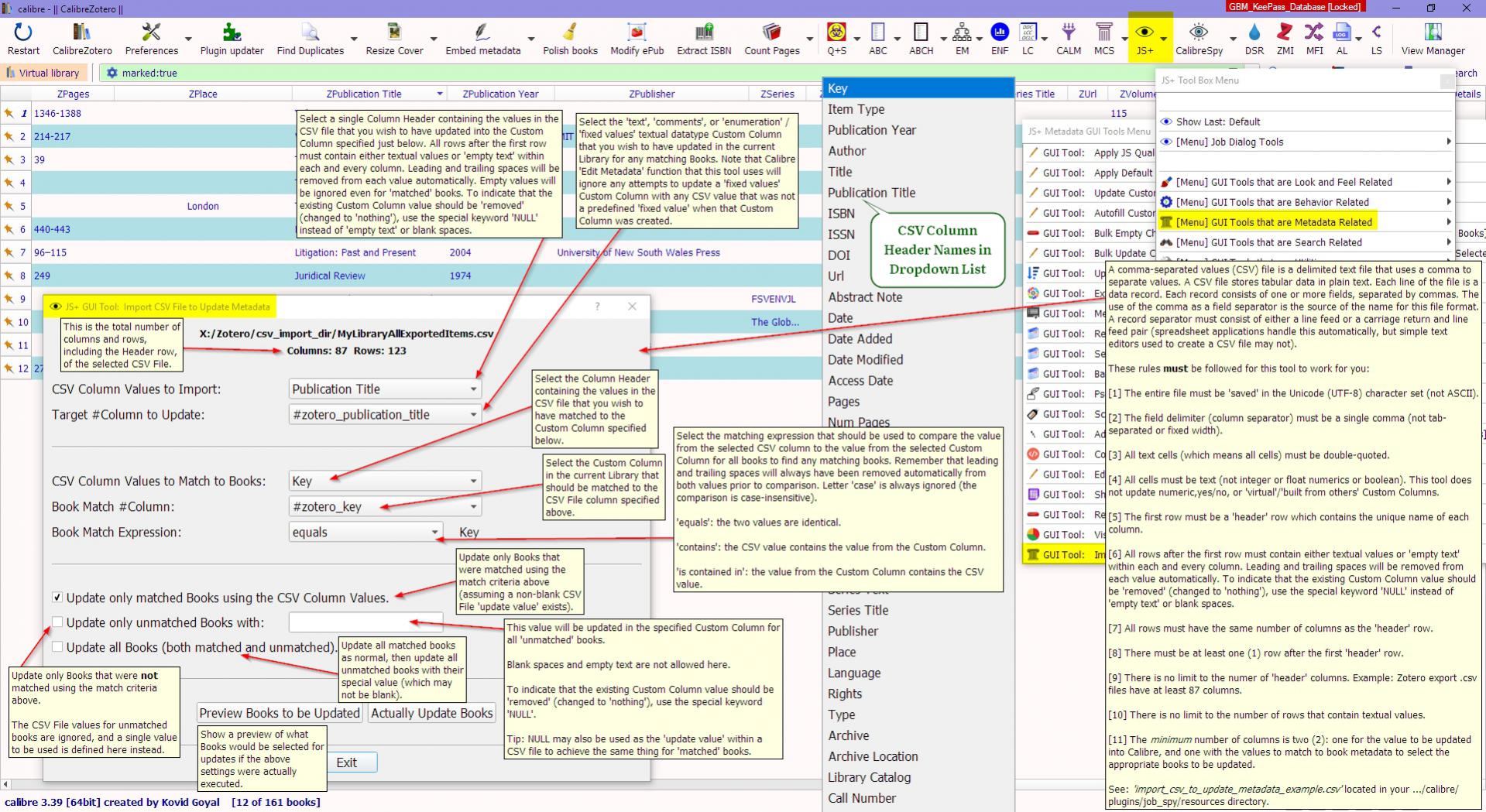

JS Tool: Import CSV to Update Metadata
Hi.
Thanks
See the attached images. Note the highlighted ToolTips. Read the ToolTips in the image and in the JS Tool.
Simply use the Calibre Catalog function to export Calibre standard column ID and whatever custom columns you need. Then, run the tool from the JS Menu.
Match on ID, since it is the unique Calibre book ID.
The Calibre Catalog exported CSV file is UTF-8 encoded and uses double-quoted delimiters. Those are required for this JS Tool. So, if you edit the CSV in Calc/Excel, you must save-as using those specified options.
DaltonST
ID:	197495   Click image for larger version
