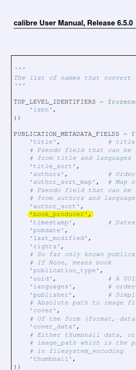

I'd like to do a template search for """book_producer""" containing "^calibre" with (formats:#=1 and formats: pdf). As shown in Calibre manual, that publication metadata field is available:
Name:	MWSnap0841 2022-10-16, 02_15_31.png

In both my production library and test library, "book_producer" is always empty. Do you have an example where it isn't? If so, what does it contain?

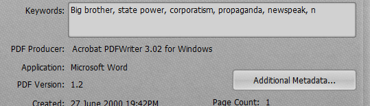

I can retrieve its value from CLI, with ebook-meta. Most pdf files have a value set:
Name:	MWSnap0846 2022-10-16, 14_45_41.png
I have attached pics showing the values I'd like to filter, and two pdf files that contain the book-producer value.

I thought that might be the case. I looked through the code and found many references to the field when processing OPFs during import and conversion but I couldn't find anywhere where it was stored into calibre's database. As you say, "welp".

book_producer is epub specific metadata, it's not in the standard set of builtin fields calibre supports in its database. It's present in the Metadata cclass because calibre sets it in epub files in various scenarios.
