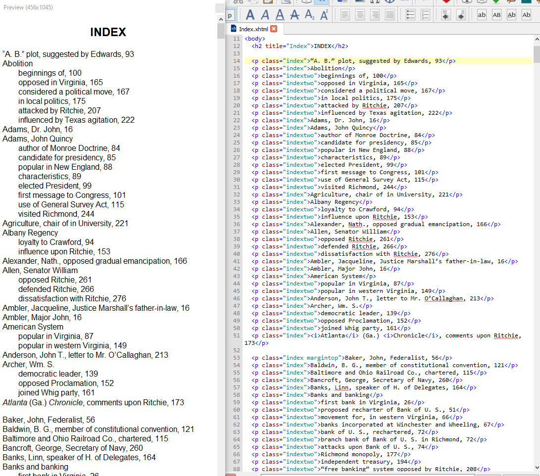

Or... another trick I use (mostly in Indexes), is:
  • I use class names + "two" or "three" on the end.
After you prettify, the HTML code naturally matches similar levels of indentation too:
  <div class="poem">
    <div class="stanza">
      <p class="poem">The cat jumped over the fox.</p>
      <p class="poemtwo">The fox jumped over the cow.</p>
      <p class="poemthree">The cow jumped over the moon.</p>
    </div>
      <p class="poem">The dog barked.</p>
      <p class="poemtwo">The cat meowed.</p>
      <p class="poemthree">The wolf howled.</p>
    </div>
      <p class="poem">... and Tex laughed.</p>
    </div>
  </div>
See the Index out of the latest latest book I worked on:
Wow, that code brings a tear to my eye, and look how easy it is to read.
Complete Side Note: That was also the first book I ever ran across where the Index's subentries were actually in page order... usually all books are in alphabetical order. I was scratching my head for a while until I noticed the pattern.

Nah, it actually made sense once I looked a little bit closer.
It allowed you to:
  • Find a given topic/person.
  • Get a quick outline/summary in "chronological order".
I did ultimately make the decision to split the index from "paragraph form":
into "indented form" though.
