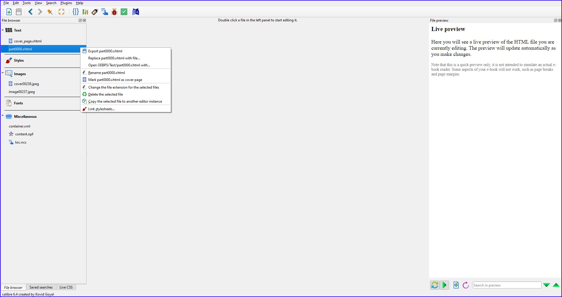

Originally Posted by retiredbiker View Post
In the editor there is a "split at multiple locations" tool. Just right-click on the big file, in the text, to see it.
Where? My screenshot below does not have that as an option.
I have been using the "Split file at selected location" button in the file preview screen, and sometimes that gets a bit annoying when there are 100+ chapters.
I know I could reconvert and use the split option in the settings, but when the chapters and paragraphs use the same tags, I haven't figured out a way to differentiate the two.

On the CODE of any HTML file
Great. Thanks!! I didn't know that was there.
