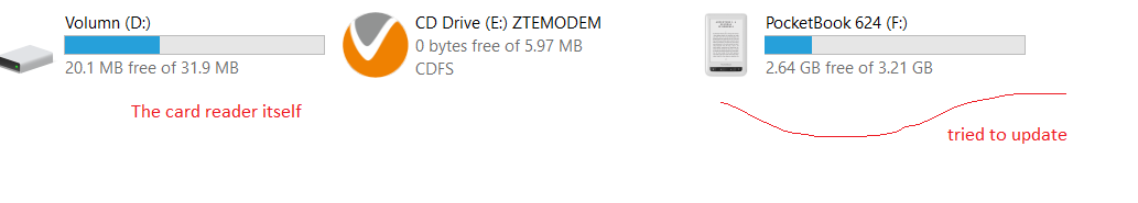

Actually, I just found the version I needed after you have provided the above link, Michal, thank you for that. It is 4.4_1739 judging by the website. However, I tried to format both the SD card reader and the SD by itself (the card that the book is on) -- and an error popped that I am unable to format them. I tried deleting the files separately and it still did not work - as soon as I deleted everything from the card reader and I tried to format it - it said unable to format and then somehow the old files before the formatting -- after I had already deleted them - popped up again, in the same place. I tried that with the pocketbook files too, with no success. Any ideas why this may be occurring?

Please stop and read this:
https://www.mobileread.com/forums/sh...d.php?t=278728
What are you doing is destroying the device irreversibly.
