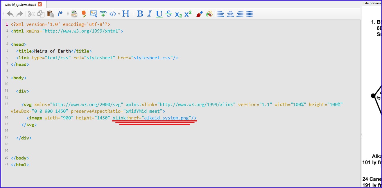

Disappearing images (png converted to jpg)
I have quite a few books that are very large - in the hundreds of mb, in some cases.
I've worked out how to use ImageMagick to convert the png files (which are nearly always - perhaps always - used in the books in question, rather than jpegs) into jpg format, and then delete the png files from the book, and finally import the jpg files into the book.
Trouble is, although all of the new jpg image files appear in the Calibre editor exactly where the old png files did, when I open up the book they're all (apart from the cover image) completely blank - just showing "img" at the top.
Do I have to somehow re-link each image with its location within the book? If so, how... ?
Yes, you have to relink each image you replace. See the screenshot below.
For each image you replace, you need to find the corresponding link in the html files and adjust the filename so it points to the new image.
If you had used the "replace image with file..." option from the context menu on the image file, this would have happened automatically, but if the image size is different, and you specified width and height (as shown in the screenshot), then that would need to be changed manually.
Is there a way to batch change files? Not that I am aware of.

Old 10-05-2022, 12:30 AM   #7
Posts: 46,617
Karma: 29634066
Bulk rename all the files to .jpg using the bulk rename tool in the editor. That will update all the links. Then use your scsript to actually convert the files to real jpg.
